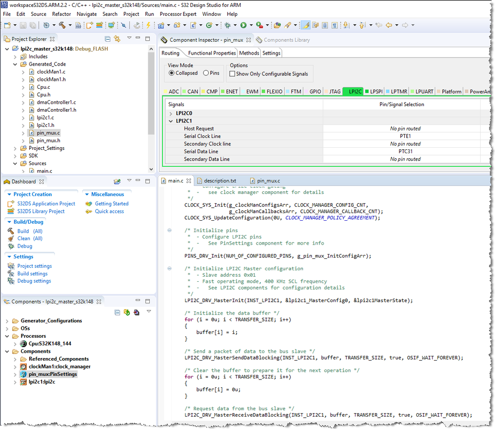

Hi All,
I want to test I2C functionality in S32K148 EVB Rev B board. Could you please help in pointing out which peripheral(s) on the board can be used for testing the same?
Also are there any links for application code which are written specifically for this EVB?
Guru
4,319 Views
Robin_Shen
Hi Guru,
Please download the latest S32 Design Studio for ARM 2.2 – Windows/Linux(REV 2.2), then you can refer these lpi2c examples of S32K148.
You may need to test the I2C functionality by using two boards or logic analyzer.
You can download Schematics and User Manual of  S32K148EVB from here.
Robin

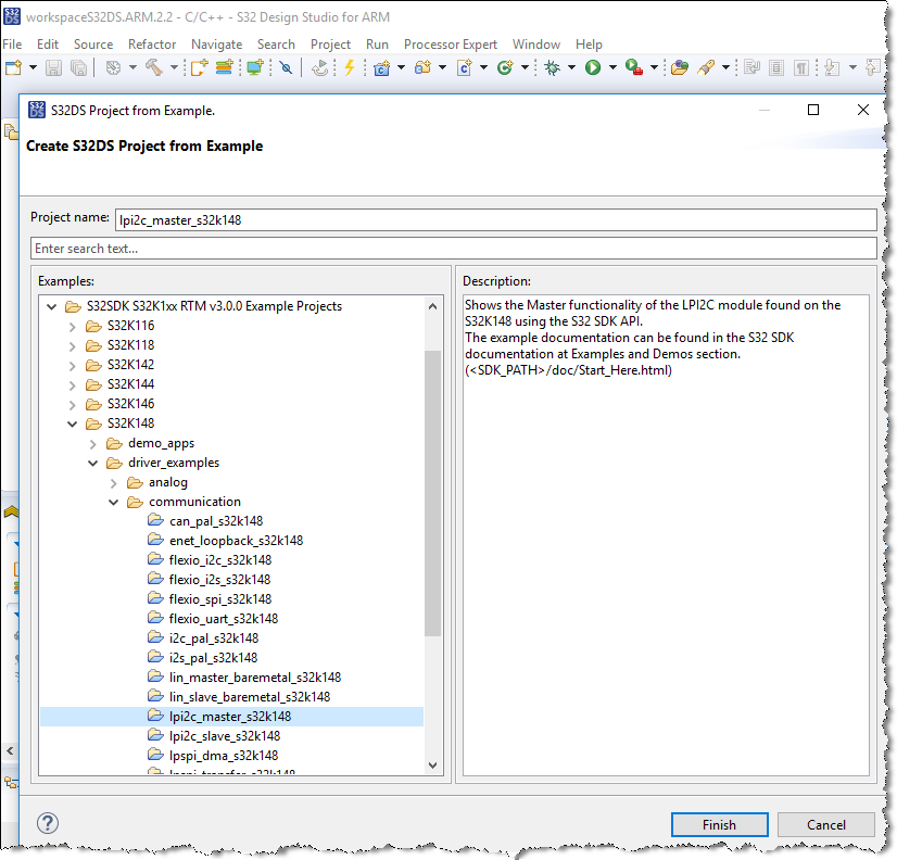

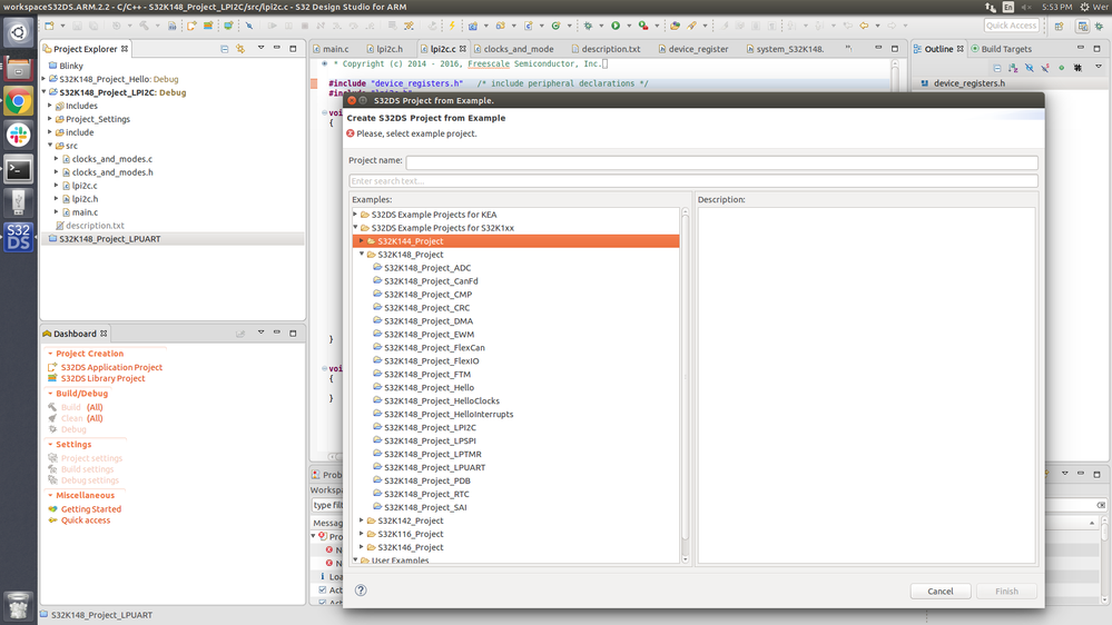

pjain
@Robin_Shen I installed the S32DS on my Linux system but I am not able to view all the I2C example codes (like lp12c_master_s32k148 example code). Could you please direct me how to get all the example codes? I tried looking for SDKs but the S32DS IDE informs me that it's upto date.Screenshot from 2021-07-20 17_53_18.png
4,043 Views
Robin_Shen
Hi pjain_123,
Please install: S32 Design Studio for ARM 2.2 - Update 1 available
Robin
4,034 Views

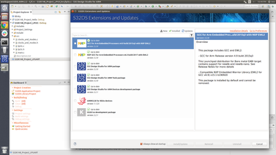

pjain
@Robin_Shen I still don't see the "S32K1xx development package", "S32K1xx SDK 3.0.3 pakage" after the update. I am using Ubuntu 14.04LTS. Is there any way I could get the update? PFA the screenshot of my S32DS Extension and Updates window
