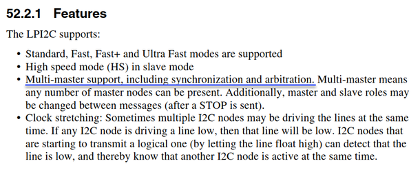

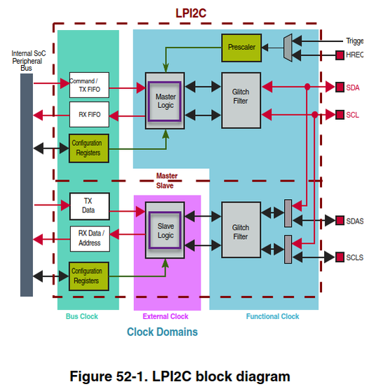

Please let me know if the below is supported on S32K14x.
 - Switching master to slave, slave to master without any reset.
 - multi master function for i2c
1,984 Views
danielmartynek
Hi @bryan_hong,
  • It can be switched without reset:
  • Multi-master is supported:
BR, Daniel
