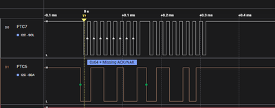

as a project I simply used demo one. Steps were, create new project from example, select I2c_Ip_Example_S32K344_Q172, open mex file, update code, build and download.
If you do not have slave connected, you get no ACK, so you will see just first byte transmitted from master. Below is connection and bus signals I had
Slave disconnected
Slave connected 

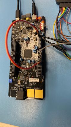

I tested quickly an I2c_Ip_Example_S32K344_Q172 example from RTD600 on S32K3X4EVB_T172.
I see it is working well using below connection
Be sure you have onboard pullup resistor mounted, otherwise use external one to have a bus properly pulled up.
BR, Petr

Andrew101
Excuse me,
Can you explain more how to wire ? I mean I need to use 2 wires or 4 wire? Thank you.
7,160件の閲覧回数

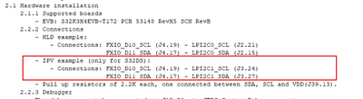

PetrS
just 2 wires
FXIO_D10_SCL (J4.19) - LPI2C1_SCL (J3.24)
FXIO_D11_SDA (J4.17) - LPI2C1_SDA (J3.27)
BR, Petr

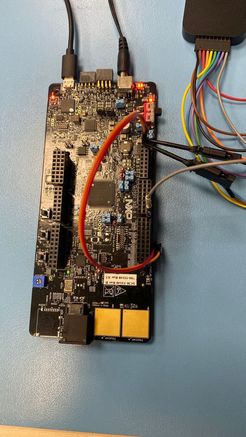

Andrew101
Excuse me,
The i2c still does not work. I only see a straight line on the logic analyer software.Also, I have a question with your result is that if you have only 1 S32K344 board and 1 logic analyzer , the board just send data and no slave, how did you get the "ACK"? Hope you share your project or some images of your hardware setup to me, It can help me imagine easier. Thanks for reading!
Slave disconnected
Slave connected 

Andrew101
The board and the wires I used are exactly same as you but I haven't seen any signal on the software. Do you have any advices for me?
