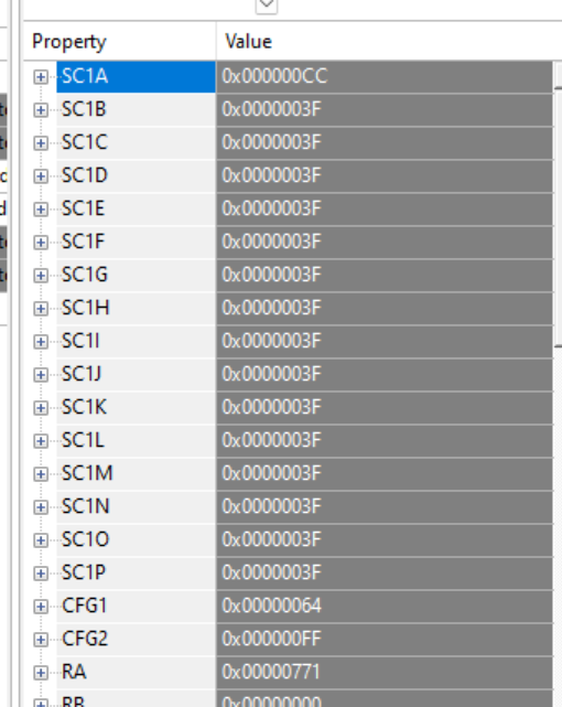

        I have read the example you give, and compare with my configurations, DMAMUX and DMA configurations have no difference. Then only difference is my project use only DMA channel0, and ADC just use the channel 0 of ADC0.
        I have test the adc and dma separatly,  both adc  dma can work normally. Dma use software trigger mode also can transfer data from ADC0->R[0] to memory. But after I config DMAMUX->CHCFG.SOURCE = 0x2A and anable adc DMAEN bit, it doesn't work. Is there any step I missed?
   Pictures below is some register's value, Please help me check. Thanks.

PetrS
is the DMAMUX clocked and do you have DMAMUX->CHCFG.ENBL set as well? Or share the code you have.

Piper123
Hi, Petrs
Thanks for your help. I have found the reason of the problem; I configured two dma channels with the same priority and use thte periodic trigger incorrctly.
