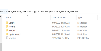

cuongnguyenphu
You can see my EB Tresos project config in above attachment:

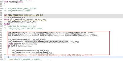

cuongnguyenphu
I think you should remove the Mcu_SetMode at the line 43 and debug first, to check that whether the LPTMR worked correctly at your side, and the LPTMR notification can toggle LPTMR_Notification flag?
Then, you can debug to see where the pointer stuck in when running with Mcu_SetMode(VLPS)

KILLERzheng
 when I remove the Mcu_SetMode(VLPS), the LPTMR_Notification does toggled and after 2.5s the LPTMR_Notification = 1.
I debug the program with JLINK, and keep the line 43(Mcu_SetMode(VLPS)), the mcu could not sleep ( or it is wake up by debuger) and continue to run line 44. So I do not know how to do that "debug to see where the pointer stuck in when running with Mcu_SetMode(VLPS)".
