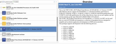

VaneB
Hi @cranes
The problem looks to be not related to a missing package, so let's try updating the packages listed above and then delete your project and create a new one.
  • S32 Design Studio Debugger Core
  • S32 Design Studio Platform package
  • S32 Design Studio Platform Tools package
  • GNU ARM PEMicro Interface Debugging Support
16,357件の閲覧回数
cranes
Hi VaneB,
They are updated like this:
But at the end of updating, the message is shown as below. I am not sure if they are actually updated.

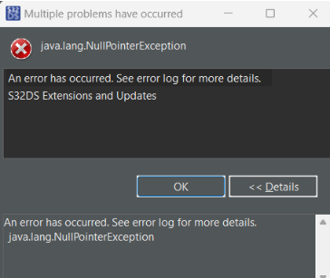

And then I tried to create a new project, the same errors come up after adding the component "Port".

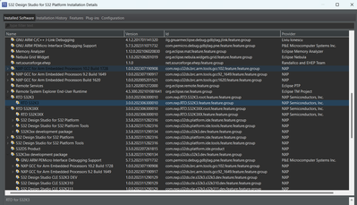

I think that the problem could be related to a typo in the files located at C:\NXP\S32DS.3.5\eclipse\mcu_data\components\PlatformSDK_S32K3 like Port_PBcfg.c as mentioned in the shared message error.  Please share the files mentioned in the messages errors, to verify if this is the situation. Also, please share your full installation details and how the project was created.
16,218件の閲覧回数
cranes
Hi VaneB,
The two files are attached.
This is the screenshot of the installation details. I don't see how it can be exported.

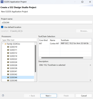

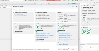

This is how I generate the project:
1. Create a new S32DS application project
2. set project name and MCU
3. configure the project
4. open the .mex file and disable the Pin configuration tool
5. open the peripheral tool and click "+" next to MCAL and choose "Port" in the pop-up window
6. click "OK" and then I see this
In step 3, I tried choose "No IO" for "IO support" as well. And the result is the same.
