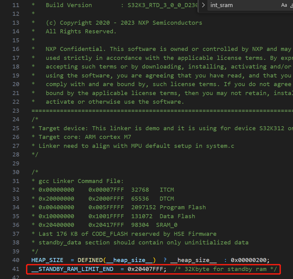

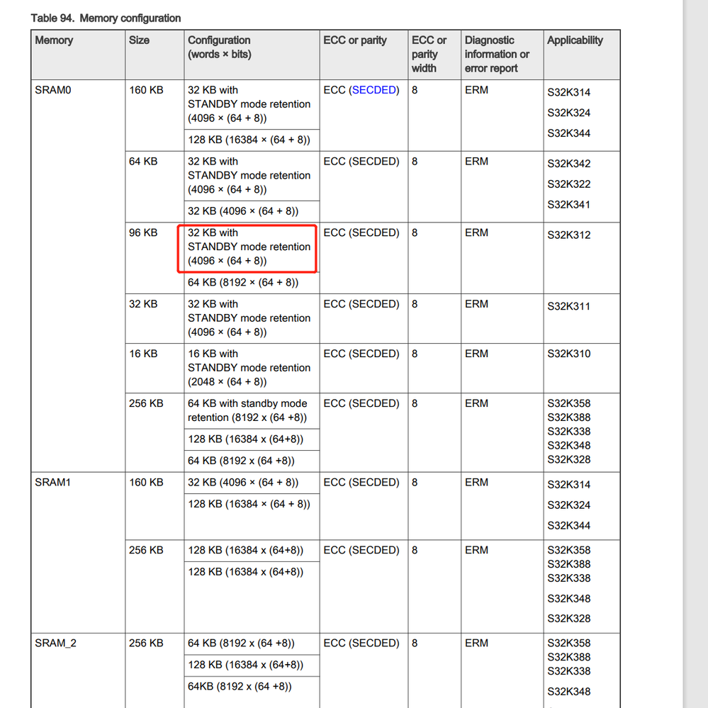

The S32K3x manual and RTD mention the memory allocation, specifically stating that 32KB of SRAM is designated as Standby RAM.
Can someone please tell me how Standby RAM is utilized? What issues can arise if the space of Standby RAM is occupied while using SRAM?
