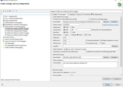

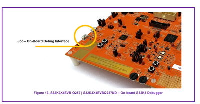

Dear Nxp experts:
From document 'S32K3X4EVB-Q257_HW-UM.pdf', there is an On-Board debugger .
But how can I connect the EVB to debug from S32DS V3.4?
In S32DS V3.4, there is only SEGGER-J-link debug available.
FreeMaster was also installed on my laptop, but it seems doesn't support debugging either.

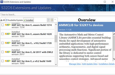

4,697 Views

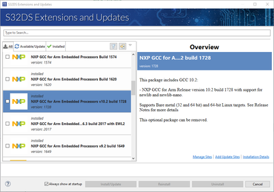

PetrS
do you have NXP GCC v10.2 installed? This seems to be missing based on Console output.
Check menu Help->S32DS Extension and Updates
BR, Petr

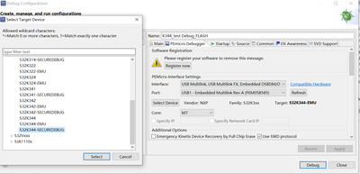

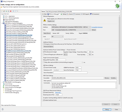

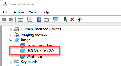

PetrS
check if interface appears in PC's Device Manager.
After USB cable connection I can see
Then within Debug Configurations of the S32DS 3.4 select desired project debug config from "GBD PEMicro Interface Debugging" and within PEmicro Debuger tab select below interface
Finally click on Debug from this DEbug config window.
BR, Petr
4,755 Views

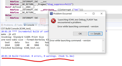

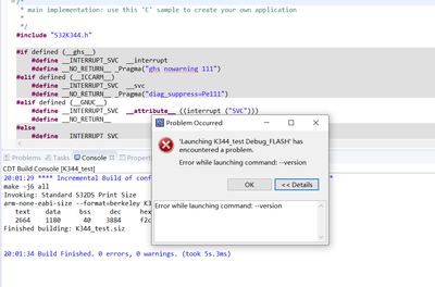

ZhouYiChuan
hello Petr:
thanks a lot. Your suggestion is tried but I got a 'Error while launching command --version' , like below:
Could you please give me further support? I'm trapped .

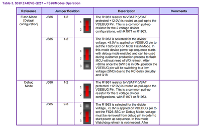

 For your reference, Following possible combinations are tried, but same launching error is got.
1) the P&E multi-link 2.0 device works well in my device manager (my window 10 is Chinese, I translate the status hint into English)
2) in the S32DS V3.4 debug configurtations window, all K344 device options (K344 EMU, K344-SECUREDEBUG) are tried
3) flashing mode and Debug mode of FS26 are also tried by different jumper setting on EVB J685
thanks and BR
Zhou YiChuan

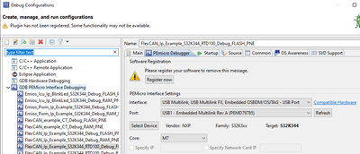

4,740 Views
PetrS
try to follow getting started guide https://www.nxp.com/document/guide/getting-started-with-the-s32k3x4evb-q257-evaluation-board:GS-S32K.... Probably you did it.
Open/debug  some demo example and use its Debug configuration. i used e.g.
It is connected properly and can be debugged.
BR, Petr

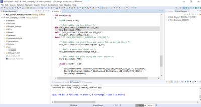

4,718 Views
ZhouYiChuan
Hi Petrs:
I tried as the getting started guide https://www.nxp.com/document/guide/getting-started-with-the-s32k3x4evb-q257-evaluation-board:GS-S32K.... . told me.
But the building of Port_Example_S32K344 failed, so I created a very simple example to start the debugging work.
Your support for the building failure is also very appreciated because I have no idea for it either.
the error hint is:
arm-none-eabi-gcc.exe: fatal error: cannot execute 'as': CreateProcess: No such file or directory
compilation terminated.
make: *** [src/subdir.mk:20: src/main.o] Error 1
make: *** Waiting for unfinished jobs....
make: *** [generate/src/subdir.mk:51: generate/src/Dio_Cfg.o] Error 1
but the compiler didn't tell me which file or directory can't be found . So I don't know how to fix it.
The whole project and S32 DS console output are attached.

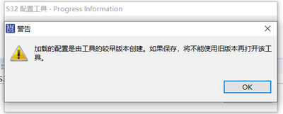

I'd like to describe some other things when I was doing 'new project from example'
the file 'example_Port.mex' was opened as the guideline .
1) S32 DS  told me -- the 'example_Port.mex' is created by earlier version tool, if saved, couldn't be opened with earlier version tool .....
But it doesn't matter.

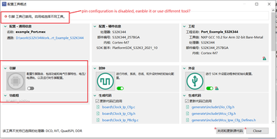

2) It told me the Pin configuration is not enabled. I enabled it, but in fact , I thinks it is not important because SIUL is not used in the example.
Not matter I enable or disable the Pin configuration, the 6 building errors are same.

4,684 Views
Guofred
Hi @ZhouYiChuan ,
Yes, i use the sample code to compile. it is normal work.
you can check you GCC 1728  and linked resource path again. thanks.
Best regards.

4,698 Views

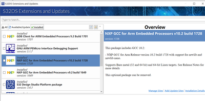

PetrS
BR, Petr

ZhouYiChuan
@PetrS,
@Guofred,
thanks a lot for your kind support!
After the building environment was setup on another laptop, the building and debug of port_example project succeeded.
the laptop is Thinkpad with Intel CPU.
I don't know why the S32DS V3.4 on the  laptop with AMD CPU doesn't work.
I'll re-install the S32 DSV3.4 and update package on it.
thanks and br

ZhouYiChuan
Hi, @Guofred:
After re-install the S32K344 tool-chains on the laptop with AMD CPU, the port_example can be built.
What is the root cause of the issue before re-installation, sorry I don't know.
thanks and BR
ZhouYiChuan

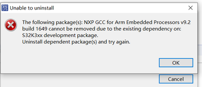

4,687 Views
ZhouYiChuan
hello Petrs:
the NXP GCC V10.2 and V92. are all installed, maybe there is a conflict.
But the NXP GCC V9.2 can NOT be uninstalled because there is dependency with S32Kxx development package
Maybe I have to re-install the whole building environment
thanks and BR
