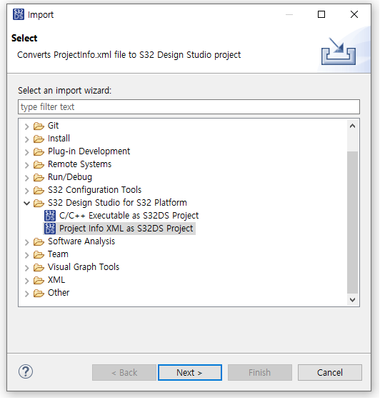

autics

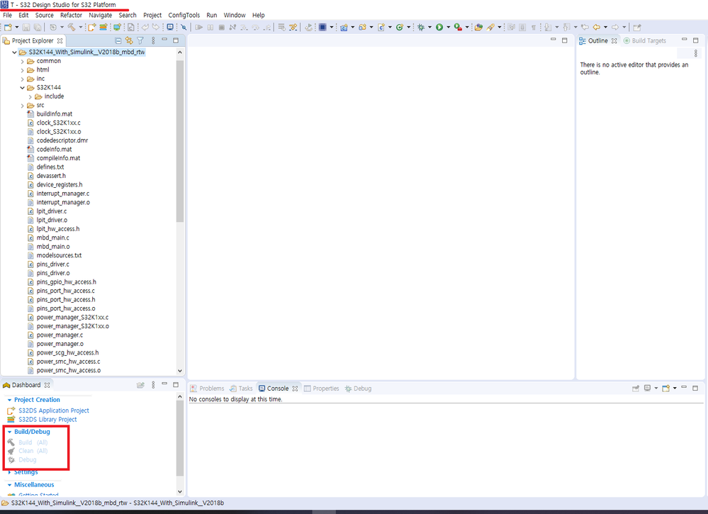

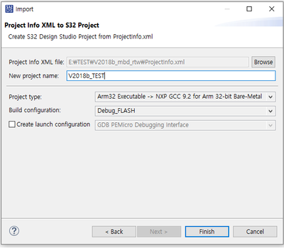

The project was created as below by importing XML as shown in the image above.
The problem is that the build area is not active as shown in the image below.

VaneB
Hi @autics
Check the following thread, it has information related to the topic.
The PROJECT by importing the .xml file into s32ds PA cannot be compiled, there is no C/C++ bulid.

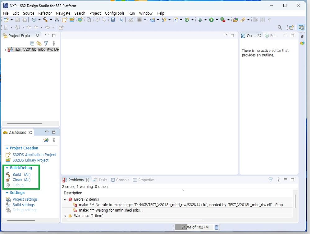

autics
You were right.
The build icon has been activated as the space has been removed.
There is another problem as shown in the attached image below.
A build error occurs.
5,519 Views
VaneB
Hi @autics
This topic has been discussed in other threads. Check them, it might be useful for you.
No Rule to Make Target error
No rule to make target
No rule to make target (MCU on Eclipse)
5,495 Views

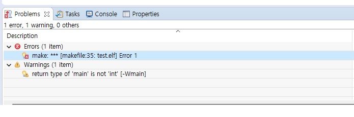

autics
Hi @VaneB
I selected a specific file and built it as shown in the image below.
A new error occurs.

VaneB
Hi @autics
The 35 only means line 35 in the makefile. There should be more output in the console log indicating errors/warnings...

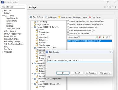

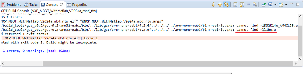

autics
I'm so sorry.
I'm still not good at using the S32 Design Studio for S32 Platform 3.4.
The error is as shown in the image below.
How can I set it up in the attached image below?

VaneB
Hi @autics
This is usually caused by an incorrect location pointing, please verify the library location.

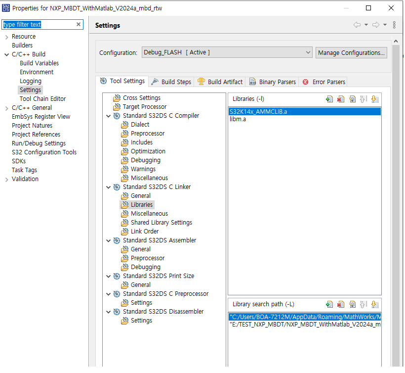

autics
Hi.@VaneB
S32 Design Studio for ARM Version 2.2  creates libm.a file and builds well.
However, libm.a file is not generated in program S32 Design Studio for S32 Platform 3.4
I'm sorry, but please support me one more time.
5,334 Views
VaneB
Hi @autics
Try looking for the .a file directly into the Simulink files and copy the path. If the error persists, please help me by creating a new thread in the Model-Based Design Tools (MBDT) community. Here the responsible engineers will help you.
