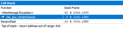

Hello All,
I have created a simple FreeRTOS MPU project by modifying "FreeRTOS_Toggle_Led_Example_S32K344" and added DIO MCAL to toggle on board LED.
My modified ReceiveTask task looks like this now:
void ReceiveTask( void *pvParameters )
    (void)pvParameters;
    BaseType_t operation_status;
    BaseType_t count = 0;
    uint8_t currentLevel = STD_HIGH;
    for( ;; )
        operation_status = xSemaphoreTake(sem_handle, portMAX_DELAY);
        configASSERT(operation_status == pdPASS);
        Dio_WriteChannel(DioConf_DioChannel_RED_LED, currentLevel);
        currentLevel =~currentLevel & 0x1;
        if(count++ > 10)
            //testResult = 0x5AU;
But as soon as it try to execute "Dio_WriteChannel(DioConf_DioChannel_RED_LED, currentLevel);", I get memory exception
But no issue is seen if I comment above line of code.
In short can you please guide me as how I can use MCAL with FreeRTOS using MPU.

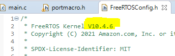

DanNguyenDuy
Hi HemantK,
what is the FreeRTOS package's name you are using?
Dan
