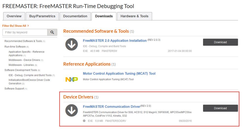

You can download the FreeMASTER Serial Communication driver package from: www.nxp.com/freemaster.  Go to Downloads section and select the FreeMASTER Serial Communication.
On this package, you will found useful documentation that explains how to use the driver (http://www.nxp.com/assets/documents/data/en/user-guides/FMSTRSCIDRVUG.pdf) and besides, some example projects for different devices.
These example projects are located at: <FreeMASTER_Serial_Communication_Driver_V2.0>\examples\SCI_driver_examples.
I hope this can help you!

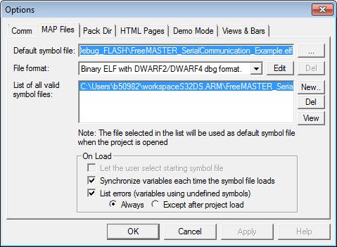

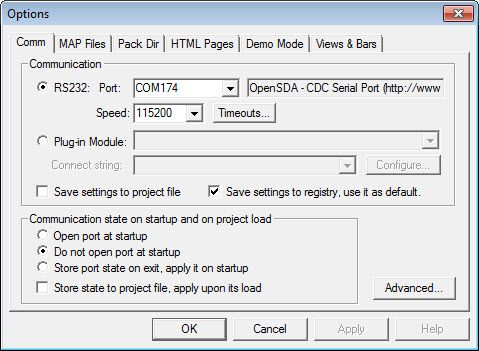

From FreeMASTER's perspective, select the project tab and then click on Options. In the new window, select the proper Port and set baud rate to 115200.
In the same window, got to MAP Files tab and load the .elf file from current project.This file is located at: <Project_location>/Debug_Flash/

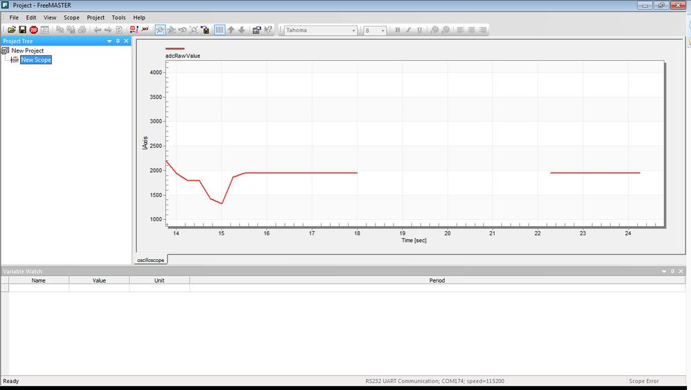

After this, you can create a new scope and add any desired variable. In my case, I added the adcRawValue variable. After everything is set, just click on the STOP icon and communication with board should be set correctly.
I hope this helps, if you still have issues, just let me know it!
