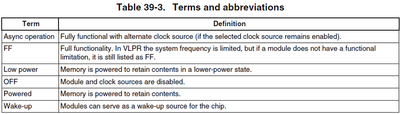

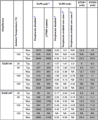

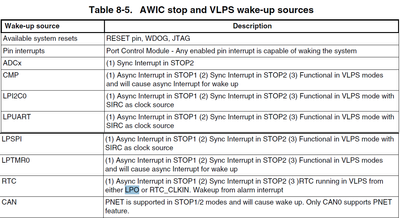

S32k1xx has four low-power modes (VLPS, VLPR, STOP1, STOP2).
Below is the current of the four low-power modes.
Below is CAN status during low-power mode.
Below is wake-up sources.
So I think your low-power should be VLPS mode. CAN is OFF in VLPS mode. If you want to wake up MCU by CAN, you need to reconfigure CAN RX pin to GOIP input and enable GOIP's interrupt before entering VLPS mode. You need to reconfigure CAN after waking up. You only do some urgent cases after waking up and reset MCU by WDG timeout.
