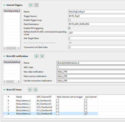

Hi, I want to learn How to use DMA to get ADC transformation result without ADC interrupt.
I used S32K344,
IDE is S32DS3.4 ,
RTD is S32K3 RTD AUTOSAR 4.4 VERSION 2.0.0
I am confused about how to config that.
Hope to get your help, thanks.

Hello @PetrS ,
In your example you used 5 ADC channels but in "Adc_Sar_Ip_1" you defined only 1 channel, is that correct?
Is it not necessary to put all channels in this array?
MVR
3,872件の閲覧回数
PetrS
actually in this example BTCU is used to trigger conversions and command list is created with 5 commands.
DMA then reads result from BCTU data register.
BR, Petr

MVR
Contributor V
Ok, I understand it,
But my question is: In "Adc_Sar_Ip_1" in the "Channel configurations array" option, don't you need to fill with the 5 channels used in your list?
3,829件の閲覧回数
PetrS
the "Channel configurations array" option is for specifying which channels will be converted during normal conversion. It configs NCMRx registers. This is not used in the example
BR, Petr
