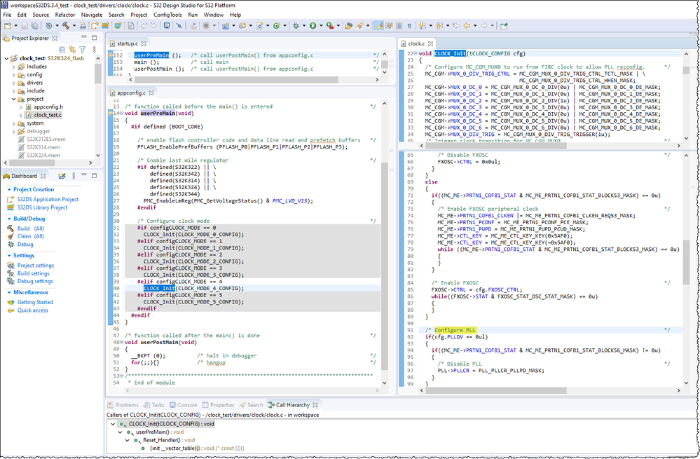

I need to switch the clock source to PLL_PHI0 manually, meaning bare-metal, using registers. It looks like there are two ways to do this: Hardware and software. I tried setting up the hardware option; however, the status register (MUX_0_CSS[SELCTL]) still shows FIRC. MUX_0_CSC[SELCTL] shows 1000b (for PLL_PHI0) however, this is not reflected in the status register (MUX_0_CSS[SELCTL]).

Please refer to the CLOCK_Init function in clock_test project.

I moved the following code (please see below) into my project and tried building, however I got 010b in SWTRG bits in the Clock Mux 0 Select Status Register, which indicates the clock I am trying to switch is not active?
"010b - Switch after the request failed because of an inactive target clock and the current clock is FIRC."
If so, how do I activate PLL?
Thanks!

Robin_Shen

I incorporated the CLOCK_Init into my project and it worked. I can see on the status register (MUX_0_CSS) that my clock source switched to the PLL_PHI0_CLK.
