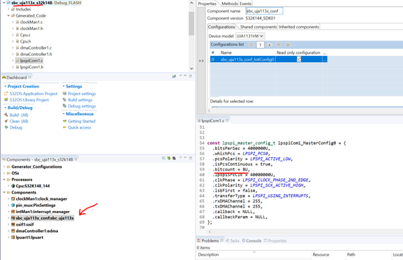

I bought a board of S32K148EVB-Q176 .
The board SCH is S32K148EVB-SCH-29644-RB and another question is SBC type is UJA1131F5v0 on board ,but one is UJA1132F5v0 in S32K148EVB-SCH-29644-RB.
And set SPI  communication from MCU to SBC with read UJA113X_SER,the pdf said  ''During a write operation, the UJA113x monitors the number of SPI bits transmitted. If the
number recorded is not 16, 24 or 32, the write operation is aborted and an SPI failure
interrupt is generated (SPIFI = 1), if enabled (SPIFIE = 1).
 '',that means frame buffer must be 16bits transmission or buffer is 8bits frist frame and need second 8bits frame to startup SBC(1131/2).
1,038 Views
Senlent
I don't quiet understand your question,if you want to communicate with SBC,you can take a look the demo provided in S32 DS,I attached it for your reference.
