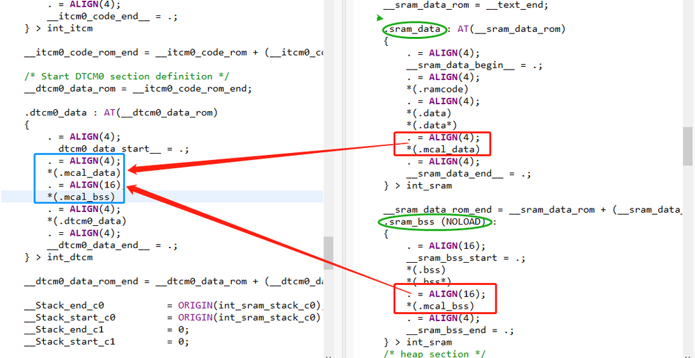

    It is too cumbersome to add keywords to each variable, if I define part of the system default sections to dtcm, is it feasible?

   Thank you for your answer .I still have some doubts, If I need to add the section attributes for all the code, it will be a nightmare...

1. Using TCM as system RAM only allows DMA, EMAC, HSE and other masters to access. (otherwise Kernel-specific access only)
2, As we imagine the way: TCM as extended RAM, when the compiler allocated RAM resources insufficient, automatically allocate part of the data to the TCM address. This method is impossible to implement. If this idea can be realized, can you provide some information?
3. When RAM resources run low, we can only manually add __attribute__ ((section(") "). .dtcm0_code") Load some resources into TCM? Or is there a better way?
