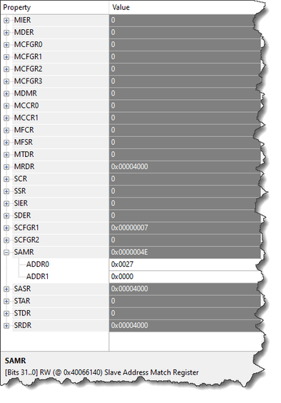

For example: Set Slave Address = 0x27,
1.Configure slave Address 0x27 (Slave address,7-bit or 10-bit) in Ipi2c1.h
lpi2c_slave_user_config_t lpi2c1_SlaveConfig0 = {
  .slaveAddress = 39U,//0x27
  .is10bitAddr = false,
  .slaveListening = true,
  .operatingMode = LPI2C_STANDARD_MODE,
  .transferType = LPI2C_USING_INTERRUPTS,
  .dmaChannel = 0U,
  .slaveCallback = lpi2c1_SlaveCallback0,
  .callbackParam = NULL,
2.Use "LPI2C_DRV_SlaveInit(INST_LPI2C1, &lpi2c1_SlaveConfig0, &lpi2c1SlaveState);",it will call function" LPI2C_Set_SlaveAddr0();" and then set Slave address7-bit or 10-bit.
3.Register value.

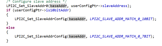

       You can refer to example "lpi2c_slave_s32k118" in S32 DS, and this example shows the LPI2C Slave functionality. The purpose of this demo application is to show you the usage of the LPI2C module available on the S32K118 MCU as a \b slave using S32 SDK.
usage or detail please refer to lpi2c_slave.dox in project.
 * @brief Configure the ADDR0 address for slave address match
 * This function configures the ADDR0 value which is used to validate the received
 * slave address. In 10-bit mode, the first address byte is compared to
 * { 11110, ADDR0[10:9] } and the second address byte is compared to ADDR0[8:1].
 * In 7-bit mode, the address is compared to ADDR0[7:1]
 * The formula used for address validation is configured with function
 * LPI2C_Set_SlaveAddrConfig().
 * @param baseAddr  base address of the LPI2C module
 * @param addr  ADDR0 address for slave address match
static inline void LPI2C_Set_SlaveAddr0(LPI2C_Type *baseAddr, uint16_t addr)
    uint32_t tmp = baseAddr->SAMR;
    tmp &= ~(LPI2C_SAMR_ADDR0_MASK);
    tmp |= LPI2C_SAMR_ADDR0(addr);
    baseAddr->SAMR = tmp;
 If you are using LPI2C as slave mode base on bare-metal, please refer to the SDK driver to modify the code as you need..
