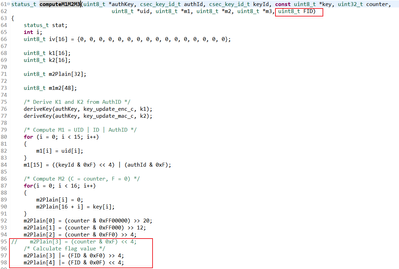

Hello @wang_q4,
Please refer to AN5401 Getting Started with CSEc Security Module.
the below code is from csec_utils.c (csec_keyconfig_s32k1xx SDK example)
You could add the attributes before it is encrypted.
uint8_t FID = 0x00;  // or set FID = WRITE_PROTECTION | BOOT_ PROTECTION | DEBUGGER_PROTECTION | KEY_USAGE | WILDCARD
/* Calculate flag value */
m2Plain[3] |= (FID & 0xF0) >> 4;
m2Plain[4] |= (FID & 0x0F) << 4;

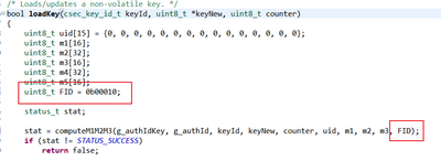

Hi Daniel
    Referring to this figure, I would like to ask if if SFE=0x00, FID=0b00010 should be set in computeM1M2M3 if the key is to be used for CMAC generation, similarly, if SFE=0x01, if the key is to be used for CMAC generation FID=0x000100, I wonder if there is any problem with this understanding.

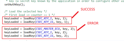

    In addition, I set FID=0b00010 in computeM1M2M3, which caused an error when I updated the key. What was strange was that the first key update was normal, but the error occurred in the second update. Could you please explain?The following is the update I made, please point out if there are any mistakes, thank you very much.

I load the key according to the following code,
but I have returned "STATUS_SEC_KEY_WRITE_PROTECTED" when restoring the factory settings

danielmartynek
Hi @wang_q4,
According to this thread of yours, you have already at least one key protected.
https://community.nxp.com/t5/S32K/CSEs-failed-to-restore-factory-Settings/m-p/1307273#M11340
In this case, it can be erased, unfortunately.
