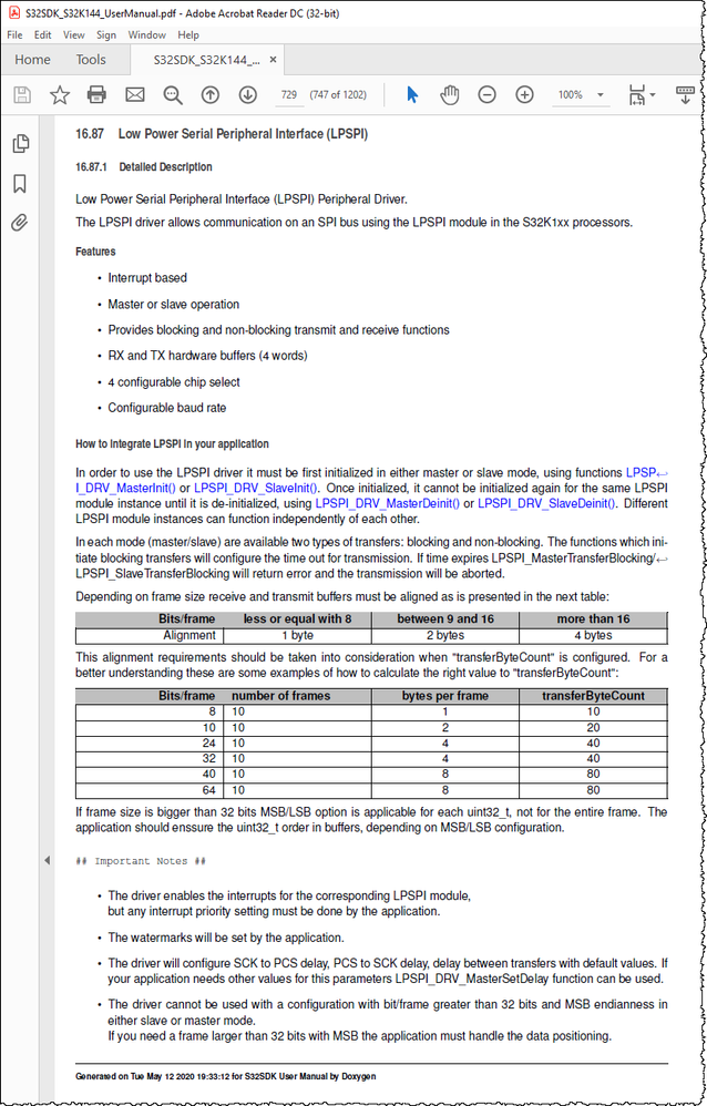

Seems that you are refer S32K144_Project_LPSPI bare metal example. Then you can refer: AN5320 Using LPSPI on KL28Z
If you want to use the S32 SDK, please read the S32SDK_S32K144_UserManual.(C:\NXP\S32DS_ARM_v2.2\S32DS\software\S32SDK_S32K1xx_RTM_3.0.0\doc\S32SDK_S32K144_UserManual.pdf)
lpspi_dma_s32k144 and lpspi_transfer_s32k144 can be found in S32SDK S32K1xx RTM.
