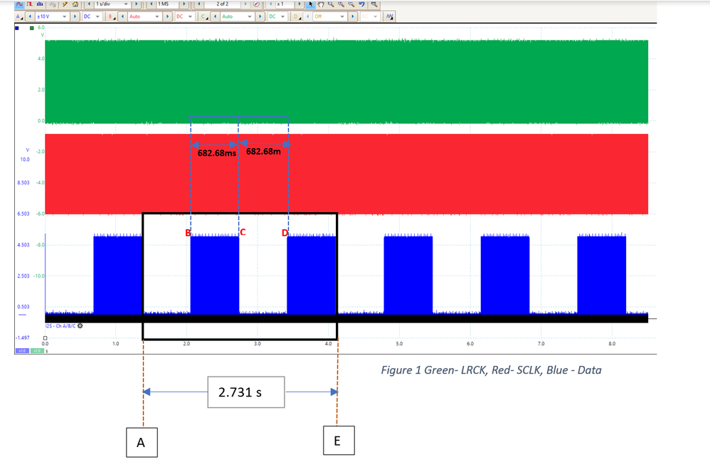

For my application, I want continous audio data transmitted to my amplifier to get continous sound. I am using S32K142/144 board. I am using Flexio for I2S communication. Please suggest which method should I follow to transfer data i.e., Polling, DMA or Interrupts.
Currently I am using DMA method, data is getting transmitted but after each iteration of data transmission again clocks are reinitialize, due to this my amplifier is taking time to generate PWM signals. Please suggest proper method so that I can transfer continous data without any reinitialization.

For continuous audio data transmission, DMA is typically the most suitable option it is scalable to high frequencies and large buffers and ensure that data transfer is constant and without interruption.
It is helpful to examine the data frame and clock signals to check for any gaps or timing inconsistencies during the process. If you can share the data frame or clock signals, I can help visualize and analyze any potential issues in the transfer process.

Prerna_Nibe
Thank you for your response.
Please find the attached image of time difference of gap.
In below image A and E are clock initialization gaps and B, C, D are call back gaps.
