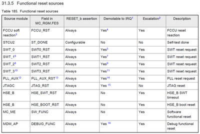

Hi NXP:
I tried to reset MCU by S32_SCB->AIRCR register, but it can't work.
now I have been using swt driver(watchdog) for implemention.is it possbile
to reset MCU by S32_SCB->AIRCR register, thanks.

This is because S32_SCB->AIRCR is not implemented on S32K3. The following are the functional reset sources supported by S32K3
You can generate a SW reset through the POWER driver instead. Please refer to this community post: S32K344 How to manually trigger one Function Reset - NXP Community.

Hi Julián:
solved by NXP power driver, thanks.
