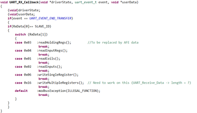

I am using s32k144 evaluation board, and I was using the UART_PAL library for receiving the data over UART using the MODBUS protocol. I used thenon blocking uart_receivedata() API in the while loop and was using the callback to check for the receive event and receive the data.
Things worked until I was certain about the length of data to be received, but when the length of data to be received is not fixed and varies time to time, what I am supposed to do?
I saw a number of threads of the same, but none of the threads provides with an absolute solution, I request you to please guide me with a proper solution, if possible, provide a piece of code/screenshot of the same.
I have attached a screenshot, and here the length of data to be received is uncertain in different cases, inside the switch statement.

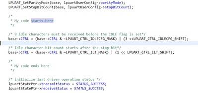

1. In LPUART_DRV_INIT function, you have to configure the peripheral registers to enable the IDLE LINE INTERRUPT & set the number of idle characters to be received before the IDLE flag is set. You should look at the reference manual for that. I have configured it for 8 idle characters & I am attaching the screenshot here.

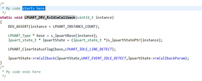

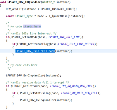

2. Inside the LPUART_DRV_IRQHandler, you have to check whether the IDLE_LINE_DETECT flag is set or not & if it is then call the function LPUART_DRV_RxIdleCallback(It is not there by default, user needs to define this) . Please note - This Function needs to be called at the starting of the IRQ_Handler.

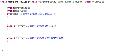

3. In the file - (callbacks.h) , inside the enum - uart_event_t, define an event UART_EVENT_IDLE_DETECT.
4. Define the LPUART_DRV_RxIdleCallback & provide a function prototype of the same.

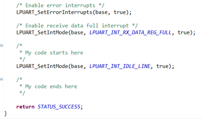

There is just one more thing that is missing in this guide but is present in the link that @Robin_Shen has sent. I will include it here as well.
6. In LPUART_DRV_StartReceiveDataUsingInt() function, enable the CTRL[IDLE]
