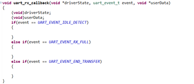

I am using s32k144 evaluation board, and I was using the UART_PAL library for receiving the data over UART using the MODBUS protocol. I used thenon blocking uart_receivedata() API in the while loop and was using the callback to check for the receive event and receive the data.
Things worked until I was certain about the length of data to be received, but when the length of data to be received is not fixed and varies time to time, what I am supposed to do?
I saw a number of threads of the same, but none of the threads provides with an absolute solution, I request you to please guide me with a proper solution, if possible, provide a piece of code/screenshot of the same.
I have attached a screenshot, and here the length of data to be received is uncertain in different cases, inside the switch statement.

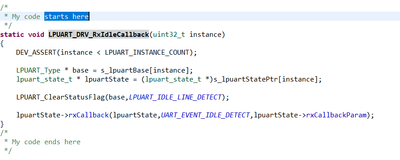

1. In LPUART_DRV_INIT function, you have to configure the peripheral registers to enable the IDLE LINE INTERRUPT & set the number of idle characters to be received before the IDLE flag is set. You should look at the reference manual for that. I have configured it for 8 idle characters & I am attaching the screenshot here.
2. Inside the LPUART_DRV_IRQHandler, you have to check whether the IDLE_LINE_DETECT flag is set or not & if it is then call the function LPUART_DRV_RxIdleCallback(It is not there by default, user needs to define this) . Please note - This Function needs to be called at the starting of the IRQ_Handler.
3. In the file - (callbacks.h) , inside the enum - uart_event_t, define an event UART_EVENT_IDLE_DETECT.
4. Define the LPUART_DRV_RxIdleCallback & provide a function prototype of the same.
5. After this, you can use it in your application.

Sorry the idle detection is not implemented within recent S32K1 SDK/RTD drivers. Have you refer to the discussion in S32K144 LPUART IDLE Line Interrupt Configuration ?  You need to change the SDK drivers in order to get  LPUART idle line interrupt.

There is just one more thing that is missing in this guide but is present in the link that @Robin_Shen has sent. I will include it here as well.
6. In LPUART_DRV_StartReceiveDataUsingInt() function, enable the CTRL[IDLE]
