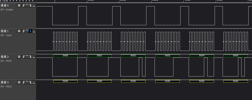

I am writting a spi driver for chip S32K146, and I want to realize spi continuous transfer.
my code is shown follow, it doesn't work.
what should I do to realize this function.
my codemy code
The wave of spi lines are shonw as fllow. The CS pin is pulled high after each byte. But I want the CS pin keep low until the last byte transfer is completed.
Can you give me some siggestions or some demo code ? Thank you !

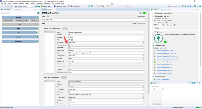

Hello @vienpeng,
Have you tried looking at the SDK example lpspi_transfer_s32k146? If you use the config tool you only need to enable this in the option the PCS continuous checkbox:

Where can I find the tool mentioned in your reply ? I just know "Processor Expert" integrated in S32DS. Your tool looks like containing more detailed configurations.
4,666 Views
Alexis_A
Hello @vienpeng.,
The new config tool is included in the latest release for the S32 Design Studio 3.3 (link)

vienpeng
@Alexis_A ,thank you, it's helpful for me, I'll study it !
