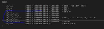

As we know, the default sram memory regions are:
What is the maximum size that can be set for the int_sram region?
398 Views
davidtosenovjan
S32K312 offers 96kB of internal SRAM. All sections can be 96kB together.
