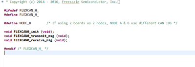

FlexCan.h -> Define nodeB as the receiver

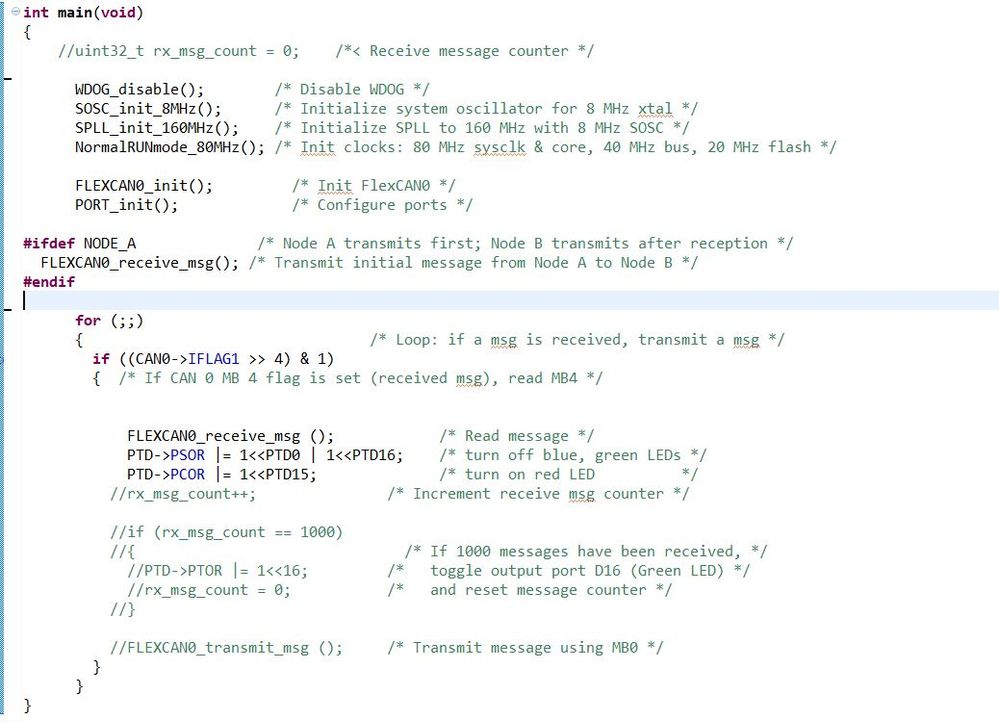

main.c -> where I configured the led blue, green and red.

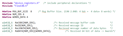

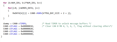

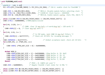

Finally the last question. For the reception of more IDs, I chose as the Message Buffer, 4, 5, 6, 7. The IDs that I want to receive are:
0xEE
0xFE
0x101
0x103
If you have time, could you tell me if I wrong something for the configuration? This is the C file FlexCAN.c

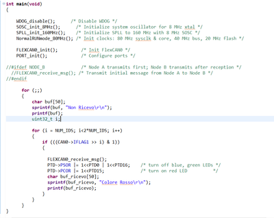

In the Main Function:
In the script FlexCAN.H I defined the Node B. I commented the function of transmission because I want to receive the messages.
I ask you what I could have missed in my code because it didn't perform very well.
Thanks for your time
