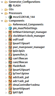

I am trying to migrate a projec from S32DS 2016.R1 to S32DS3.6.1, and switch from SDK 0.8.6 to RTD 3.0, using the S32K 146 chip.
I am manually transferring the project settings to a new project in S32DS 3.6.1, but I'm having trouble configuring the peripherals.

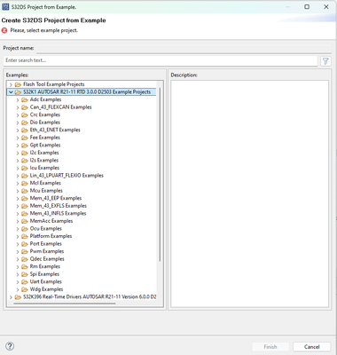

Also, I couldn't find any non-AUTOSAR sample projects for S32DS 3.6.1 and RTD 3.0 on the NXP website. If there are any available sample projects using RTD 3.0 without AUTOSAR, could you please share them? I would like to check how the peripherals are configured.
These are the componets that I had in DS2018.R1

If you have RTD installed, you’ll find several non-AUTOSAR sample projects within S32 Design Studio (S32DS).
While these samples may not be specifically for the S32K146, they can serve as useful references.
