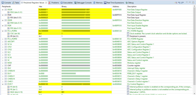

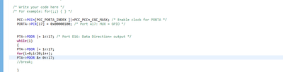

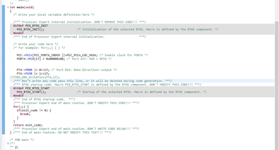

I want to make one GPIO pin (i,e A17) as High and Low. If one condition is true I am making the A17 as High else the A17 is Low.
I configured the clk for A17 with output direction. I tried the PINS_DRV_WritePin(); to make high and PINS_DRV_ClearPins(); for Low and  I verified the A17 with multi meter , the output is LOW.
then I tried with the PTA->PSOR |= 1<<17; still the output is Low only it is not changing the state.
can anyone please help me on this.

I found the register to make a pin as HIGH and LOW.
PDDR -- Is the pin used for input or output.
PDOR -- If output, set the value on the pin (0 or 1).
I verified the output, it is changing as per my requirement.
Can you please tell me the above method is correct or not.
