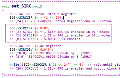

PetrS
the LPTMR module can work in VLPS but it needs the SIRC clock source to be running in VLPS.
Of course, the functional clock of LPTMR must be SIRC.
You can refer to below example; LPTMR in VLPS is used to trigger CMP, that wakeups MCU
https://community.nxp.com/docs/DOC-335759
BR, Petr

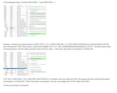

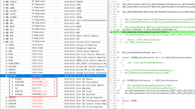

KILLERzheng
In the example project, I find the SIRCLPEN = 1 and SIRCSTEN = 1;
However, I develop my project based on S32K1_RTD_1_0_1_D2202_ASR_REL_4_4_REV_0000_20220224 and config the MCAL with EB, and I find that the "SIRC Stop Enable" could not be enabled. So if I run  "Mcu_SetMode(McuModeSettingConf_VLPS)" , the lptmr seems does not work anymore, and the wakeup function does not work, either.  In this case, the power consumption is 0.95mA 24V.
If "IP_SCG->SIRCCSR |= SCG_SIRCCSR_SIRCSTEN(1U)" run before I set mcu mode into VLPS, the wakeup function works but the power consumption is 2.30mA 24V. I thinks the power consumption is too big, even bigger than VLPR mode(1.2mA 24V).
Is there any wrong in my project?
