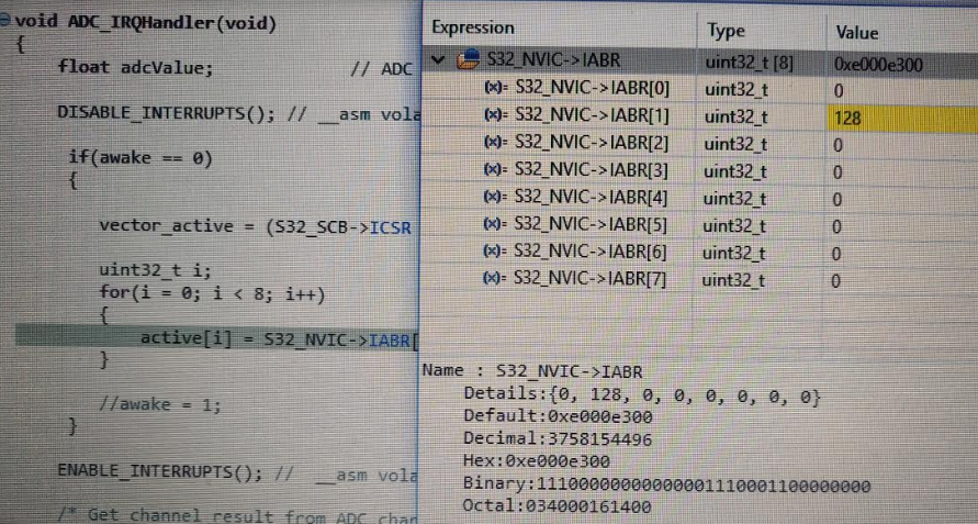

akshaykul89
Hello Daniel,
As I can understand the flow, above snippet (or similar logic) can be called from ISR. What value does "active" array signifies ? and same question is for vector_active.
I tried to have this snippet integrated in my sample code. There are two interrupts enabled to bring MCU from VLPS to RUN such as , ADC0 interrupt and Port C button interrupt. This test is driven on S32K144 EVB.
I am not able to understand significance of these values with respect to corresponding interrupt.
for ADC

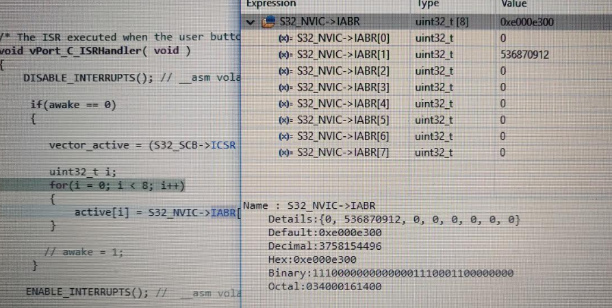

For Port C button interrupt,
How should I extract from these values , which interrupt is this?
Interrupt Active bit Register holds S32_NVIC_IABR_COUNT [i.e. 8 ] values. This might very basic question to ask but I would really appreciate your inputs on this. Thanks a lot for understanding.

danielmartynek
Hi Akshay,
IABR[1] = 128 = 0x80 = (1 << 7)
39 % 32 = 7
You should see vector_active = 55.
Similarly for the PORTC interrupt
IABR[1] = 536870912 = 0x20000000 = (1 << 29)
61 % 32 = 29
vector_active = 77.

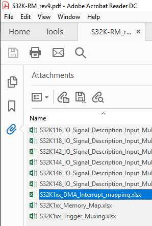

danielmartynek
This is the RM.
You should be able to find this in the S32K1xx_DMA_Insterrupt_mapping.xlsx file
Can you show me what you see, a screenshot?

akshaykul89
Hello Daniel,
Problem solved. I was referring false data. Thank you.
