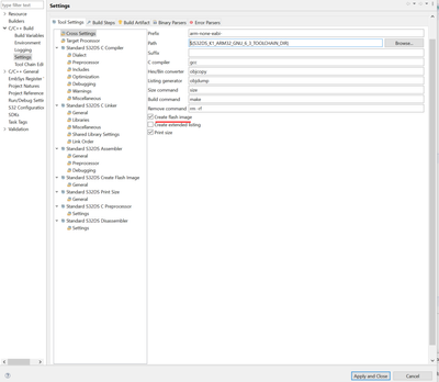

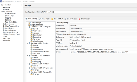

I develop S32K344 and would like to generate S19 file in S32DS. Please help to teach us how to generate S19 file in S32DS, if you can provide the picture step by step, it will be helpful. Thanks.

Hi@JAY_SUN1
1.Open the project->Properites
2.Output file format choose to ->Motorola S-record.
3.Other flag-> you can type the command:"--srec-forceS3"
--srec-len=ival
Meaningful only for srec output. Set the maximum length of the Srecords being produced to ival. This length covers both address, data and crc fields.
--srec-forceS3
Meaningful only for srec output. Avoid generation of S1/S2 records, creating S3-only record format.

JAY_SUN1
Hi Senlent,
Thanks for your prompty reply, but I can't find Standard S32DS Create Flash Image as below picture, please help to check it. Thanks.
4,150件の閲覧回数
Senlent
Hi@JAY_SUN1
I forgot this step, please try again.
