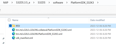

cranes
Hello PetrS,
This is what I see in my folder after installing SW32K396_S32DS_3.5.1_D2207.zip:
In the PlatformSDK_S32K3 folder, only RTD, there is no stack folder.
These are what's installed:
When creating the project from the example, only RTD, no TCP/IP stack.
Anything might be missed in my installation?
Crane

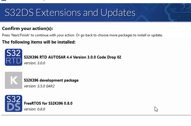

4,216 Views
jiri_kral
the FreeRTOS for S32K396 requires particular version of RTD. Based on FreeRTOS for S32K396 release notes the required RTD version is Code Drop 02 and S32K396 dev package EAR2:
With this configuration you should be able install FreeRTOS package.

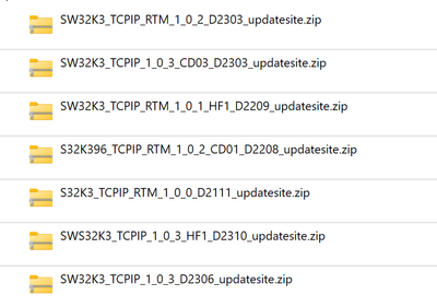

4,203 Views
PetrS
try to check "Previous" tab as well
BR, Petr
4,197 Views
cranes
This is really weird. This is what I see in the previous tab:
Thanks!
