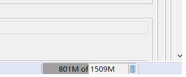

Everytime the used heap size reaches the maximum,  s32ds runs quite slow. So how to expand the heap size?新建位图图像.bmp

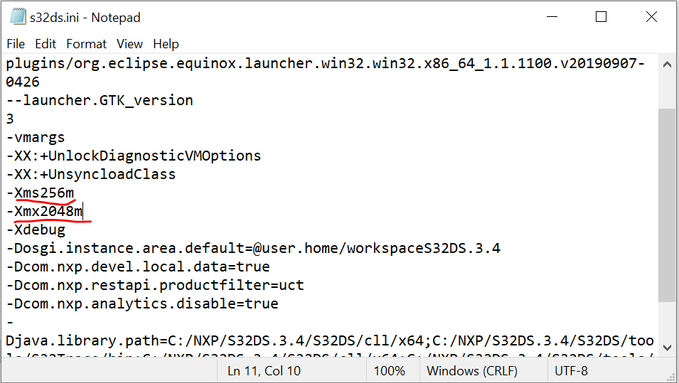

Hi@huangjia
Hi,please try to modified the red parameter.
............\S32DS.3.4\eclipse
BR!
