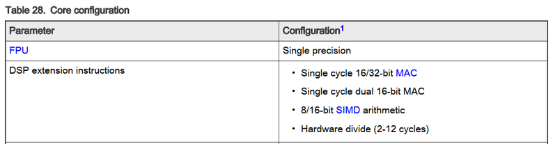

I need to use SIMD instruction on the S32K358 microcontroller. Can you please tell me, how to enable the SIMD support.

Hi Kiran,
The CM7 supports 8/16-bit SIMD arithmetic only.
https://developer.arm.com/Processors/Cortex-M7
Refer to this document:
The DSP capabilities of ARM®
Cortex®-M4 and Cortex-M7
Processors
DSP feature set and benchmarks
https://www.google.com/url?sa=t&rct=j&q=&esrc=s&source=web&cd=&cad=rja&uact=8&ved=2ahUKEwi8jLWfzLGAA...
If you use S32DS with GCC 10.2, include #include "arm_acle.h".

danielmartynek
Hi Kiran,
Processors
