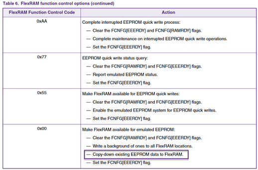

Hot to detect Unrecoverable EEPROM Failure (like bad checksum, or all copies disagree). Is there any configuration/callback is available to check/detect unrecoverable EEPROM Failure?

Hi @pratheek_b,
Please refer to AN11983 Using the S32K1xx EEPROM Functionality
https://www.nxp.com/docs/en/application-note/AN11983.pdf
Section 3.4 S32K1xx EEE ECC error handling
The copy-down of the EEPROM data takes place during the reset sequence if enabled:
And by the Set FlexRAM Make FlexRAM available for emulated EEPROM FTFC command.
