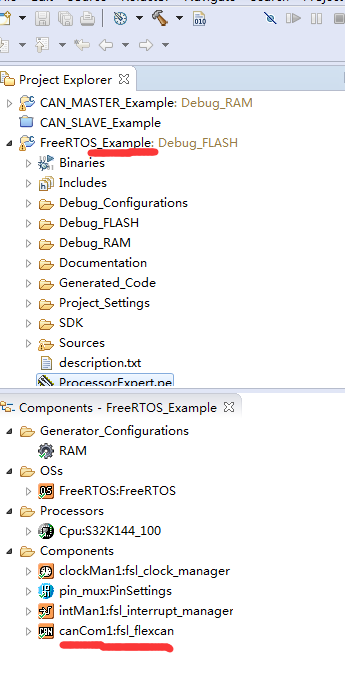

 in S32 Design Studio v1.2 I can get an example FreeRTOS_Example,I want to use FlexCAN,so
I Add the CAN module in the FreeRTOS_Example,
I add the clock initialization program is as follows:
CLOCK_SYS_Init(g_clockManConfigsArr, FSL_CLOCK_MANAGER_CONFIG_CNT,
g_clockManCallbacksArr, FSL_CLOCK_MANAGER_CALLBACK_CNT);
CLOCK_SYS_UpdateConfiguration(0U, CLOCK_MANAGER_POLICY_FORCIBLE);
Pins_DRV_Init(NUM_OF_CONFIGURED_PINS, g_pin_mux_InitConfigArr);
/*CAN test*/
FLEXCAN_DRV_Init(FSL_CANCOM1, &canCom1_State, &canCom1_InitConfig0);
The following errors in debugging:
so How to create a FreeRTOS project for FlexCAN?
