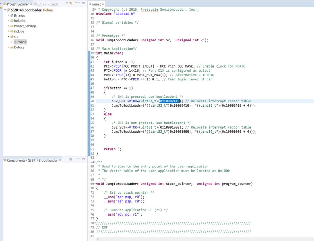

sathish_sekar
Hello Diana
I created 3 different projects in s32 design studio,
1) Proj1: S32K148_bootloader_primary - used to select the bootloader proj1 or bootloader proj2
with below memory map:
/* Flash */
m_interrupts (RX) : ORIGIN = 0x00000000, LENGTH = 0x00000400
m_flash_config (RX) : ORIGIN = 0x00000400, LENGTH = 0x00000010
m_text (RX) : ORIGIN = 0x10000000, LENGTH = 0x00001000 /* Only 4 kB are allowed for the bootloader */
2) Proj2:  Bootloader 1 with below memory map.
/* Flash */
m_interrupts (RX) : ORIGIN = 0x10001000, LENGTH = 0x00000400
m_flash_config (RX) : ORIGIN = 0x10001400, LENGTH = 0x00000010
m_text (RX) : ORIGIN = 0x10001410, LENGTH = 0x00001000 /* Only 4 kB are allowed for the bootloader *
3) Proj3:  Bootloader 2 with below memory map.
 /* Flash */
m_interrupts (RX) : ORIGIN = 0x10002410, LENGTH = 0x00000400
m_flash_config (RX) : ORIGIN = 0x10002810, LENGTH = 0x00000010
m_text (RX) : ORIGIN = 0x10002820, LENGTH = 0x00001000 /* Only 4 kB are allowed for the bootloader */
During debugging(via s32 design studio and openSDA), SP and PC registers are loaded with invalid address.
Refer the screen shot.
Any idea why the address(0x10001000) are become invalid after calling the function JumpToBootLoader()?
or method of flashing is not correct?

dianabatrlova
Can you please check if your project is loaded at the required address?
You can check the address space in the memory window (menu -> Window -> Show View -> Memory)
Diana

sathish_sekar
Hello Diana,
Resolved this issue on Friday, and I was in vacation yesterday.
Now I am able to load the Proj1 bootloader address in SP and PC registers.
How to flash this bootloaders?
Via S32 design Studio`s debug configuration or create .srec file and then flash?
Because only current bootloader memory is available in memory 0x10001000(bootloader proj1).
Previously I flashed bootloader proj2 with
 /* Flash */
But from 0x10002410, it is all set to 0xFFFFFFFF only.
