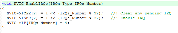

hi ,How to configure into LVD_LVW_IRQHandler,i confugured like that
but it didn't into LVD_LVW_IRQHandler,please help me ,thanks!
1,534 Views
danielmartynek
Low voltage detect interrupt: NVIC non-IPR register number is 0.
S32_NVIC->ICPR[0] = (1 << (20 % 32));
S32_NVIC->ISER[0] = (1 << (20 % 32));
S32_NVIC->IP[20] = 0x90;

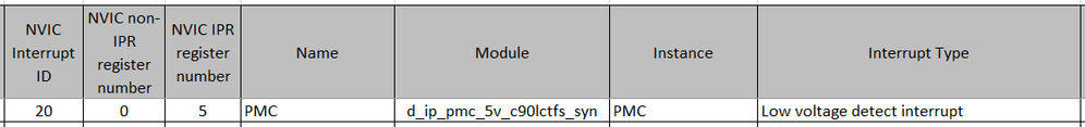

thanks so much,do you have this document ,my side is different ,my document like that ,but it is no correspondence,it like that ,can you send to me,thanks!
1,533 Views
danielmartynek
All the attachments are correct.
I suppose you use the latest S32K14x Series Reference Manual (Rev4)
LVD LVW interrupt is specified as bellow.
