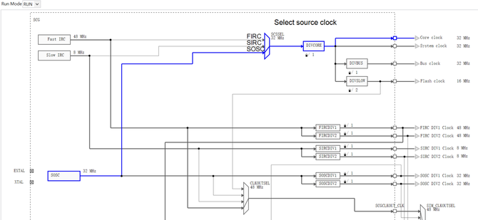

Senlent
Hi@Amrit1
yes,no PLL used on this chip,
you can change the external crystal to 32MHz, but few customers use this way

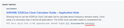

Amrit1
Is there a way I can get the sequence or the configurations I need to use it in this method? (Or any excel sheet which will generate the code for a set config)
2,237 Views
Senlent
Hi@Amrit1
the picture i show you in the last reply is from S32 DS V3.4 /V3.5
you can find excel file in the link below.
https://www.nxp.com/search?keyword=AN5408&start=0
