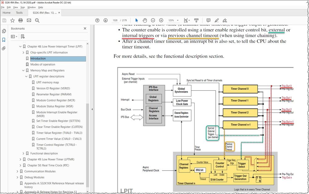

Hi fenghr7,
Internal triggers means trigger output from the other channels.
In my opinion, the different is:
When chain, the channel can only accept the trigger from previous channel timeout.
Internal triggers can accept all of the channels.

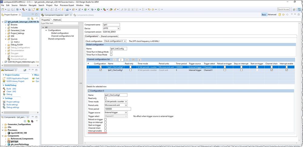

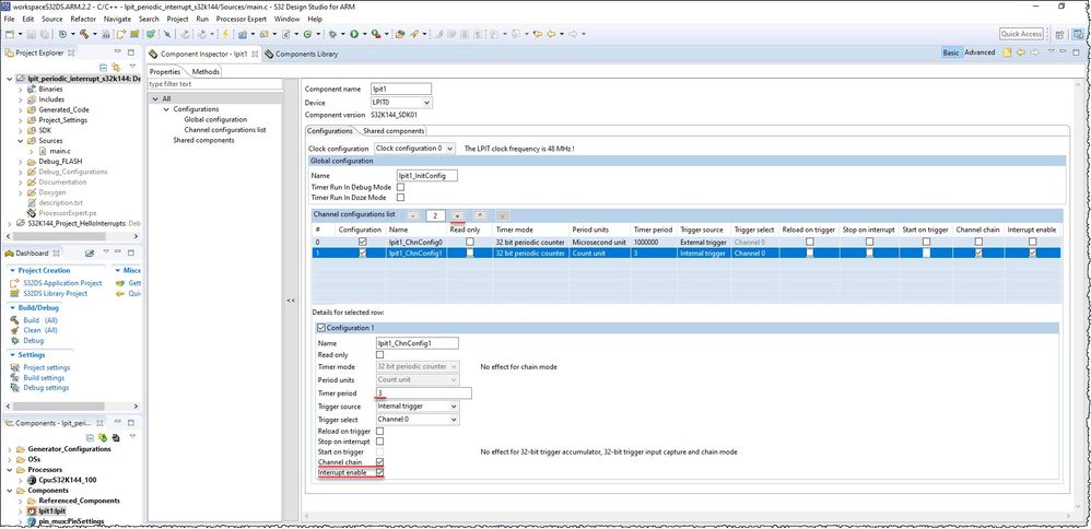

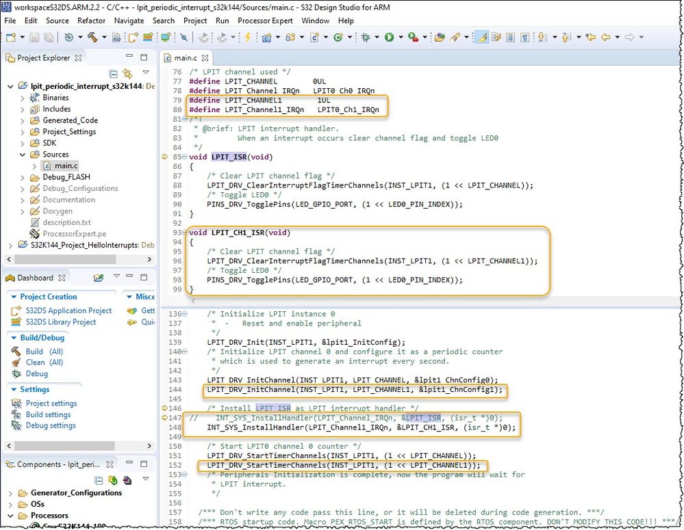

Please refer the lpit_periodic_interrupt_s32k144 example of S32SDK_S32K1xx_RTM_3.0.0.
Then modify the example by refer the images shown below:
lpit1_ChnConfig0 modify.jpgadd lpit1_ChnConfig1.jpglpit_periodic_interrupt_s32k144.jpg
Then you will see the Blue LED toggled according to the value of period in lpit1_ChnConfig1.
