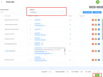

I'm trying to port 'unitified bootloader demo' on S32K144W reference board. (https://community.nxp.com/t5/S32K-Knowledge-Base/Unified-bootloader-Demo/ta-p/1423099) And I'm done to port bootloader demo into my board.
But I have no idea how to configure ECU Bus application to update the firmware. I'm newbie to this chipset & CAN communication. I attach some screen shots of application settings.
Please let me know how to configure in ECU bus. And also, please let me know how i can update new firmware using this tool. Thanks in advance.

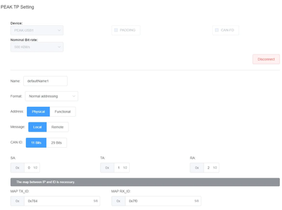

I'm done to port and test this bootloader successfully on S32K144W reference board.
For your reference, the successful CAN settings is the following:
And then you can just select Address and click 'start' button.
I hope it will be helpful.
