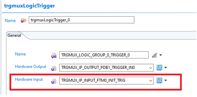

I can‘t find the way to config PDB to trigger ADC channel or group. Can you give me some information or suggestions, it is best to provide a hardware-triggered ADC demo.

Hi wuxianlong,
PDB used as default for S32K14X, so, you can find the example with trigger source is SW that was attached in the package with the link path: SW32K1_RTD_4.4_1.0.1\eclipse\plugins\Adc_TS_T40D2M10I1R0\examples.
For trigger source is HW, you can use one of them through this parameter:
I attached the example for this. Please refer it.
Nhi
