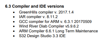

Is there SDK available which is IAR  toolchain compatible.
Controller used is S32K142.
Current SDK package used is S32_SDK_S32K1xx_RTM_4.0.0
2,872 Views
dianabatrlova
From the release note of the S32_SDK_S32K1xx_RTM_4.0.0 can be seen information below:
So, S32 SDK supports IAR v 8.11.2
Diana
