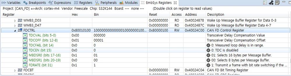

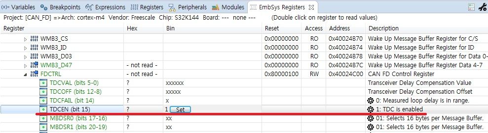

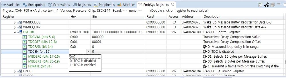

■ At the EmbSys Registers :
 1. I changed TDCEN bit to 1
 2. but this bit was not changed (the bit was returned to initial value 0, TDC is disabled)

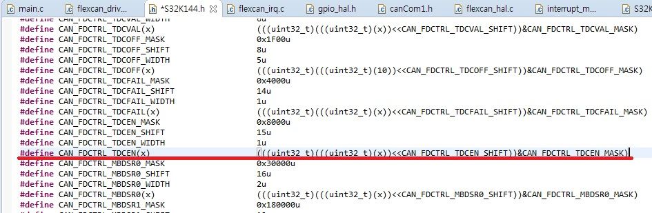

■ At the source code :
< Before code change >
< After code change : from x to 1 >
 2. and TDCEN bit was changed (enabled) during RUN.
 3. but TDCEN bit was returned to initial value (disabled) during SUSPEND
