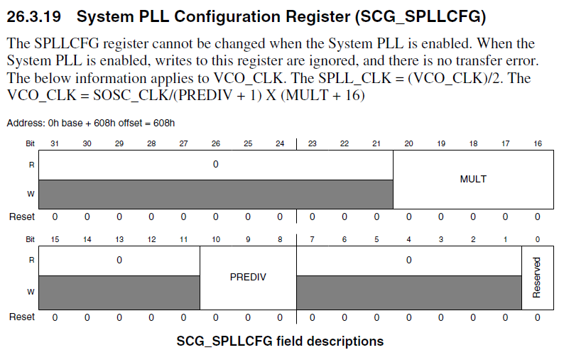

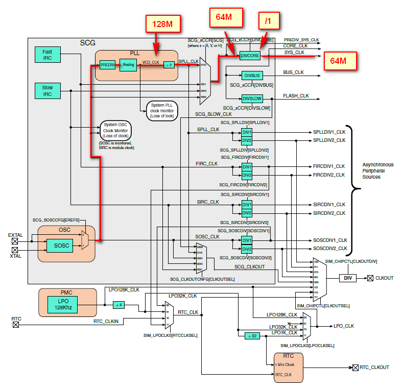

cheukeichoy
Hi Afzal,
   The clock path you need is below.
according to the descrition of the System PLL Configuration Register,you shoud be setting the MULT to 0, and setting PERDIV to 0.
so, you can try this code snippet. I hope I can help you.
    /* SPLL Configuration 64 MHz */
    SCG->SPLLDIV = 0x00010101u; /* SCG_SPLLDIV: SPLLDIV3=1, SPLLDIV2=1, SPLLDIV1=1 */
    /* PREDIV = 0     8 MHz / 1 = 8 MHz */
    /* MULT   = 0     8 MHz / 1 * (0+16) = 128 MHz VCO */
    /* SOURCE = 0     system OSC (8 MHz) */
    SCG->SPLLCFG = 0x00000000;
    while(SCG->SPLLCSR & 0x00800000u);
    SCG->SPLLCSR=0x01;          /* SCG_SPLLCSR: SPLLEN=1 */
    while(!(SCG->SPLLCSR & 0x01000000u));
