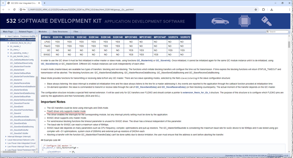

I am using the i2c_pal project for S32K144EVB which uses FLEXIO for the I2C Master and LPI2C0 as the salve.
I would like to reconfigure to use LPI2C1 as the Slave please.
When i choose the drop down in processor expert for the resource i can only choose FLEXIO or LPI2C0 which are both already in use.
Im sure its a case of adding a new resource in processor expert but i cant figure out how.
Project attached for reference. Thanks

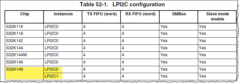

Hi Rich,
Sorry, only S32K148 has 2 LPI2C instances.
FlexIO driver only supports master mode. This is why you can not configure FlexIO_I2C as Slave.
Robin

OKay, so i now realise there is only one LPI2C BUS for use, However, I would like to swap the example so that the master is LPI2C and slave is FLEXIO.
Is it as simple as changing the "Device" in the i2c1 and i2c2 components? i have tried this and although i can swap the device resource, it removes the slave tick box from the i2c1 slave configuration and puts a stike through along the entire line, if i try to re-enable the tickbox it only momentarily takes the tick and then removes it striking through the option again.
Any ideas?
Thakns
Rich
