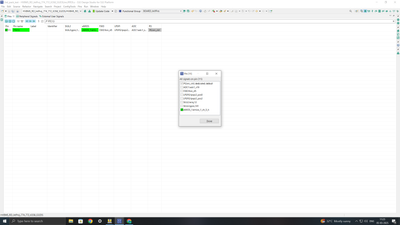

Hi NXP team,
I'm using a custom board with an S32K358 microcontroller. In my board, one pin is optionally dedicated for VRC. Now I want to use that pin as GPIO or FlexIO. Is it possible? Please assist me.

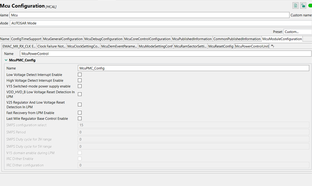

Shivanand
Hi @VaneB,
As you told me, me, until and unless I enable vrc_ctl, it is disabled. Even if I try to make it gpio or emios, the pin is always high at 3.3 V.

Shivanand
Hi @VaneB
The values of PMC registers, if any issue how can i resolve it.

VaneB
Hi @Shivanand
Thank you for sharing the information. Since PCM_CONFIG[LMBCTLEN] and PCM_CONFIG[LMEN] are set to 1, this means that the External BCTL regulator for V15 and the Last Mile regulator are both enabled. Please disable these settings as mentioned in previous shared threads.

Shivanand
Hi @VaneB .
The settings which are in the old thread are disabled . But in the register it  is set to 1.
