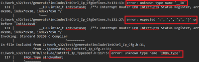

I tried the way you mentioned. I create an empty project in S32DS, then move the folder of include and src in the example project to the empty project. It doesn't work and I got the build log as attached.
Do you know who might know how to import the example project from the RTD for S32K3xx? What I am trying is an example project from the MCU's RTD package. There should be a guideline about how to build and test the example project. There is readme.txt in the example project folder, but unfortunately, it doesn't work to follow what's in it as described in my previous post.
Thanks!
Crane
18,286 Views
petervlna
Your log says you are missing header files.
Do you have those header file in your project?
Peter

Yes, that's correct. But if we look at the errors occur from the beginning as first a few in the below screenshot, which come from the files generated by EB Tresos and RTD, they are not relevant to this file. And actually adding check_example.h indeed doesn't remove any of these errors. Attached is the new build log file.
At the end of the log file, there is "error: 'VV_RESULT_ADDRESS' undeclared". This macro 'VV_RESULT_ADDRESS' is in the Makefile in the example project folder. Do we need to add this file to the project generated in S32DS? If so, where to add? I already tried and it didn't work to add it in the project root folder as in the example project.
Obviously it doesn't work to just copy the folders of include and src from the example project to the newly generated project in S32DS. There are many things missing, not just check_example.h.
So, what is the correct way to build an example AutoSAR project from S32K3xx RTD? Just feel so weird that there is example projects in RTD but there are no guidelines about how to build the example project. What is missing here?
