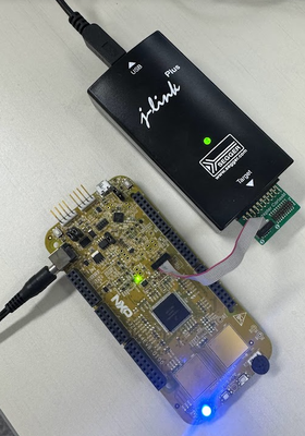

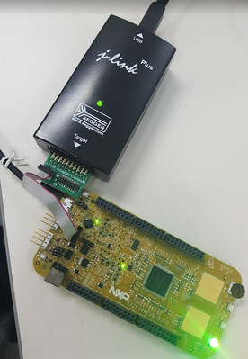

I have S32K144EVB as below.

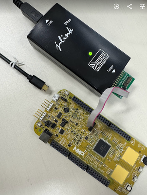

I connect J-link with S32K144EVB  as below.
and I have make `S32K144_Project_Hello.elf`
so, I execute run but error dialog be present as below.

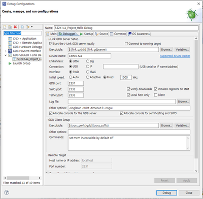

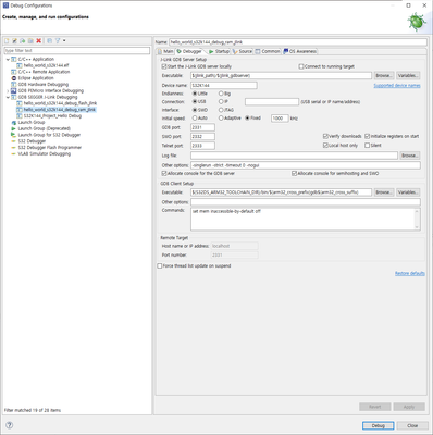

this is my Debug configurations,
I set Device name to Cortex-M4, Is it right ?
I want to know
   - how to set Device name on `Debug configurations`

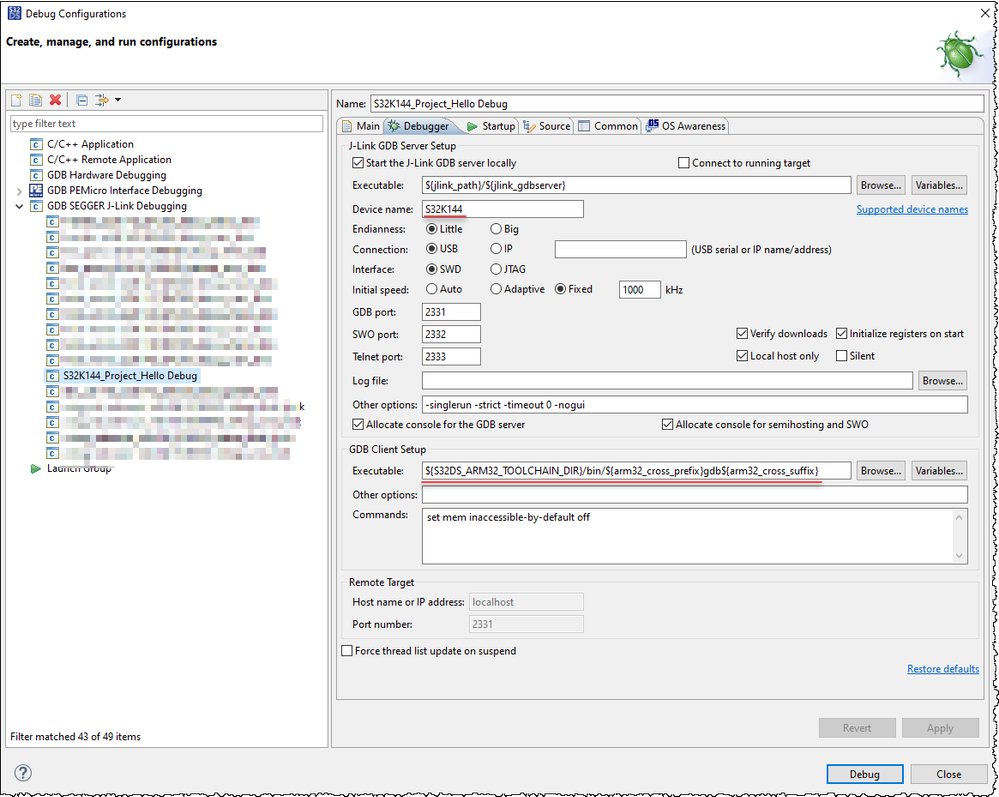

Robin_Shen
Hi Bryan,

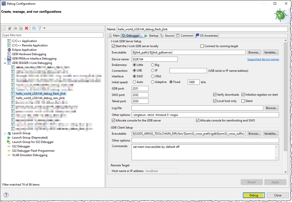

You connect the wrong debug interface. The header is for onboard debugger OpenSDA(K20). Please connect your SEGGER J-Link to J14. refer to 1.1 Get to Know Your Evaluation Board
Here is the Debug Configurations of GDB SEGGER J-Link Debugging
Device name: S32K144
Executable: ${S32DS_ARM32_TOOLCHAIN_DIR}/bin/${arm32_cross_prefix}gdb${arm32_cross_suffix}

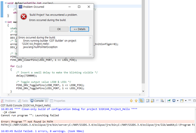

I have two issue
One,
I open S32K144_Project_Hello from `AN5413SW`
After I have reinstall  S32DS v3.4, I have meet the below error message when I execute build.

I open hello_world_s32k144 from `File->New->Create S32DS Project from Example`, then this is built.
so I change Debug configuration what you say.
and then, I execute run, it's may be flashed

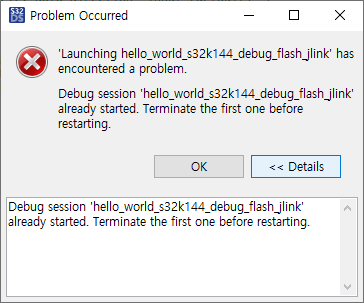

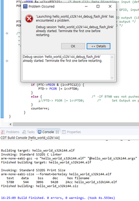

BTW, I execute re-run, I meet the below error. How to do stop debug session ?

20,240 次查看
Robin_Shen
1. AN5413SW is developed with S32DS for ARM, so you may need to import those projects with S32DS for ARM instead of S32DS for S32 Platform.
Orphaned toolchain com.freescale.s32ds.cross.gnu.arm.cortexm.toolChain.debug.743572426 (Standard S32DS toolchain for ARM).png

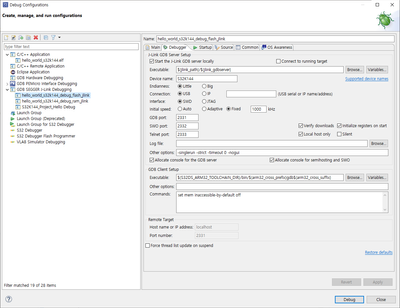

2. Have you tried to Debug the hello_world_s32k144 project? Will the board blink RGB LEDs?

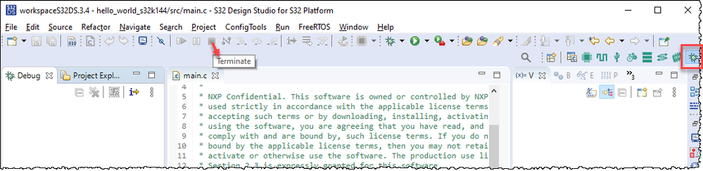

20,229 次查看
Robin_Shen
Have you terminated the first Debug session? Here you can terminate Debug. If still not work, maybe restart S32DS.

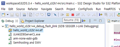

bryan_hong
Senior Contributor I
Dear NXP
Of course, I terminate Debug and reset EVK and re-plugged j-link and EVK.
so,
When I debug with hello_world_s32k144_debug_ram_jlink, RGB LEDs blinked.
At this ram case, If I click debug, S32DS set to below.
then If click `resume`, RGB LEDs blinked.

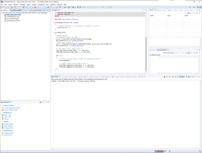

But
, When I debug with hello_world_s32k144_debug_flash_jlink, S32DS set to below.
Resume set to blur
and RGB LEDs did not blinked no more.
thanks
Bryan
20,221 次查看

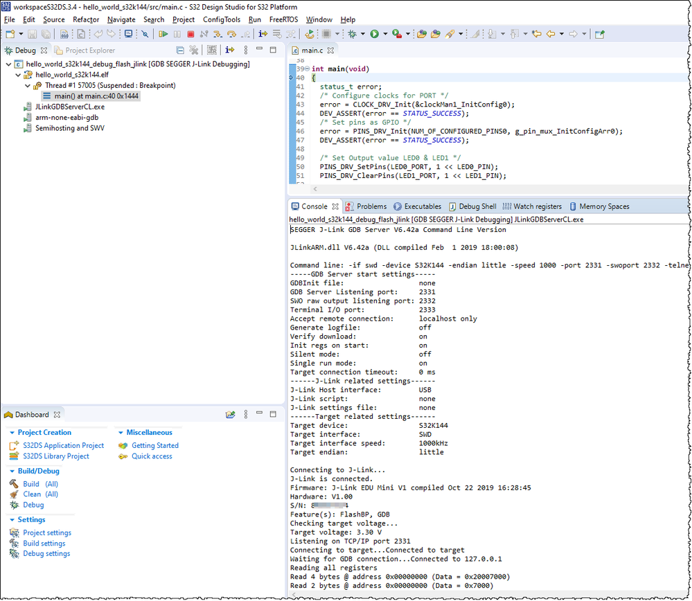

Robin_Shen
Strange. I am able to use SEGGER J-Link to debug hello_world_s32k144 in S32K1 SDK RTM4.0.3
It is recommended to update to the latest version of SEGGER Software

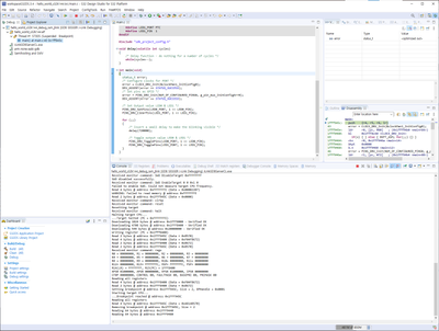

At this case, I have run S32DS. and execute Debug as below. the resume button still blurred.
I have attached JLinkGDBServerCL_console.txt on my side.
plz any comment if you find any difference with your JLinkGDBServerCL_console

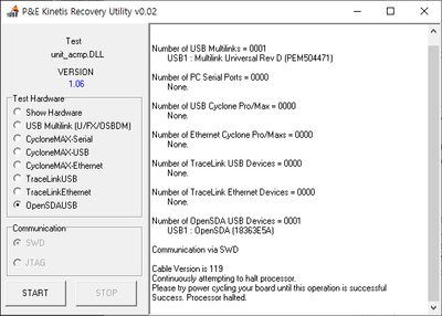

20,184 次查看
Robin_Shen
You need to power the S32K144EVB:
J107 1-2 S32K144 powered by 12 V power source
2-3 (Default) S32K144 powered by USB micro connector
Otherwise, S32K144 has no power at all. (Your J107 is connected 2-3, so the D3 GREEN (PWR_LED) does not light up when the USB cable is not plugged in)
This is mentioned in 3.1 Set Up Jumpers in S32K144EVB Evaluation Board.
Since the S32K144 is cycling reset, D1 RED (SDA_RST_LED) lights up. This may be caused by the fact that there is no working code program in S32K144.
The onboard PEMicro OpenSDA is able to program S32K144 too. Please use P&E Recovery Utility halt MCU, then you should be able to program S32K144.
20,163 次查看
bryan_hong
Dear @Robin_Shen
-> Yes, correct you are right.
and P&E Recovery Utility work well as below.
and APPVER set to 1.19 as below.

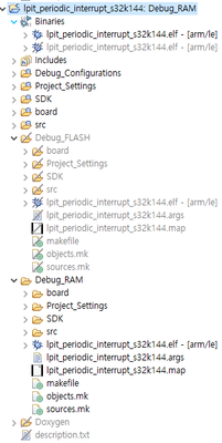

From now. I have a some question.
Q1, What should I do with lpit_periodic_interrupt_s32k144.srec file ?

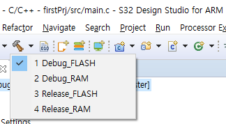

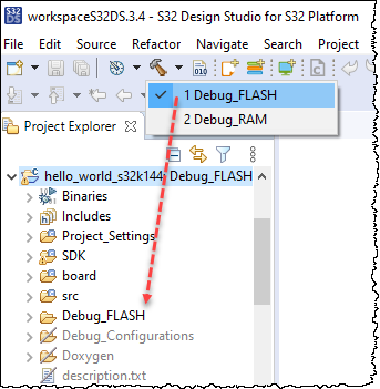

Q2, Why make Debug_FLASH to blurred as below?
Q3. I can find Debug_FLASH on `S32 for ARM` but I can find that on `S32 Platform`
thanks
Bryan
20,158 次查看

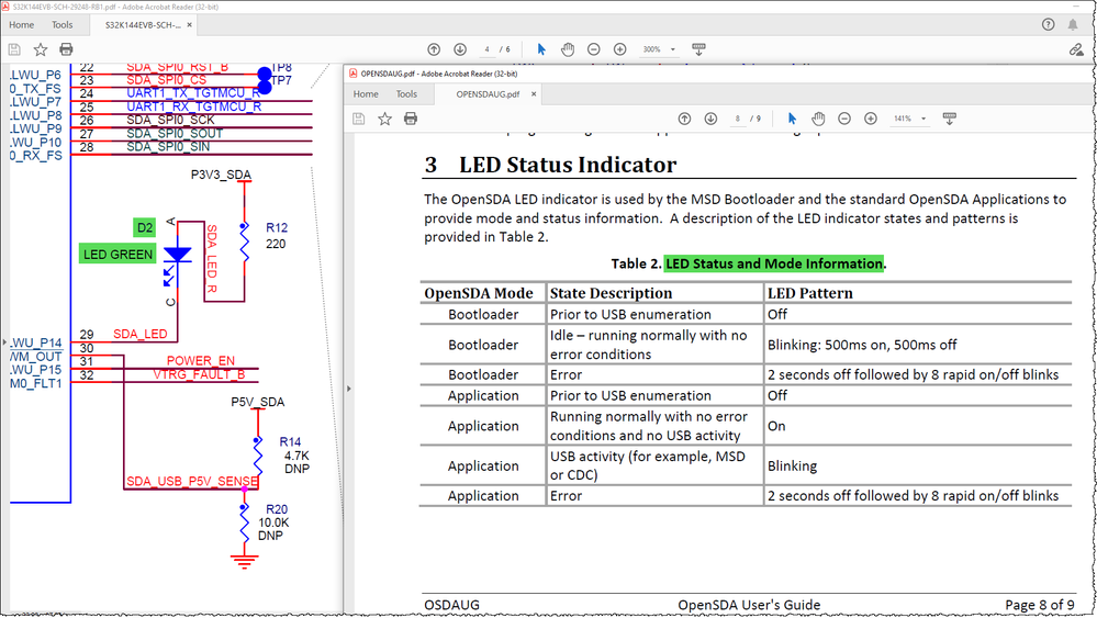

Robin_Shen

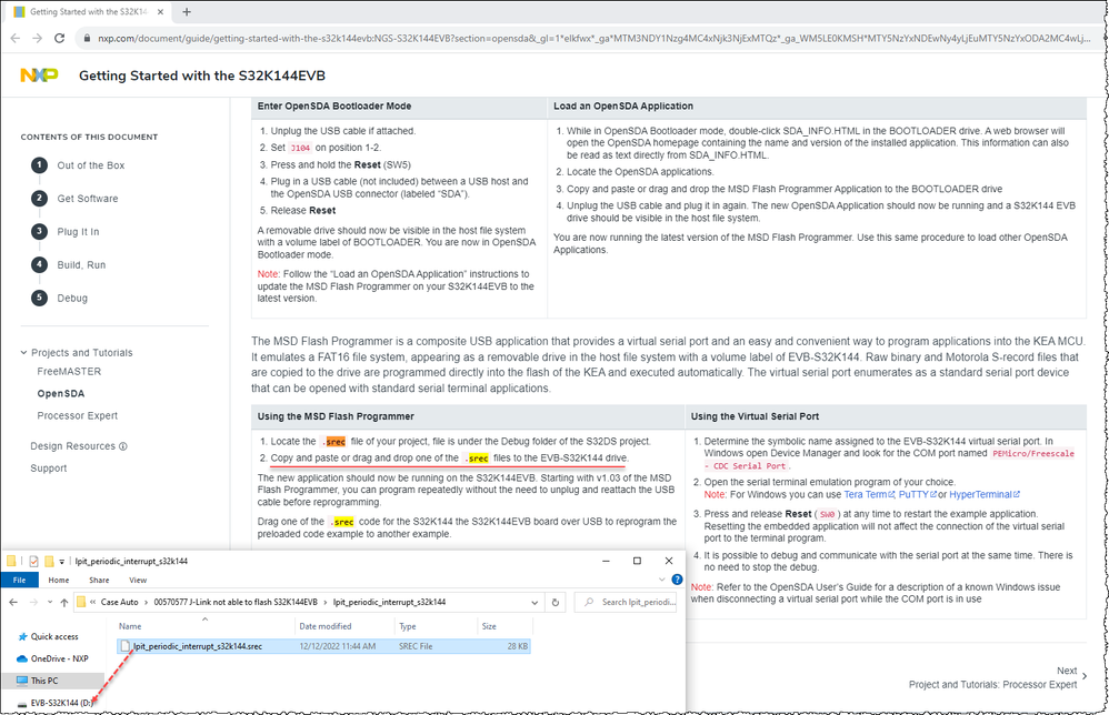

A1:Set J104 on position 1-2.
D2 500ms on and 500ms off, OpenSDA is bootloader mode Idle. (LED Status Indicator S32K144EVB D2 LED GREEN.png)
If you don't Press and hold the Reset (SW5) when plug in a USB cable, will it appear as a removable drive in the host file system with a volume label of EVB-S32K144?
If so: Copy and paste or drag and drop one of the lpit_periodic_interrupt_s32k144.srec to the EVB-S32K144 drive. Or try to debug it when the MCU is halt.
Copy and paste or drag and drop one of the .srec files to the EVB-S32K144 drive..png

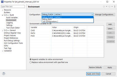

A2\3: Please build Debug_FLASH

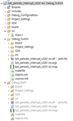

bryan_hong_3-1697677522215.png  <-- I can not find this
btw, I found out how to change project to Debug_FLASH.
