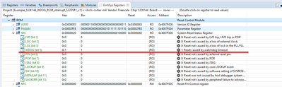

There is Example S32K144 WDOG RCM interrupt:
https://community.nxp.com/t5/S32K-Knowledge-Base/Example-S32K144-WDOG-RCM-interrupt/ta-p/1107039
The SRS is read-only. "The reset state of these bits depends on what caused the MCU to reset." When you use this example you can see that the reset is caused by WDOG.
